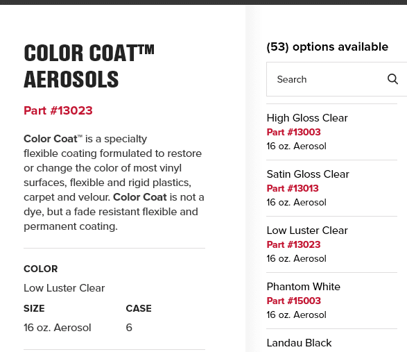

I looked at SEM and they have some clears in their Color Coat line
Their tech support recommended the Low Luster Clear to match the look of factory vinyl, which he said is even lower gloss than the satin. Does that sound appropriate advice?
I also asked what would happen if you used a vinyl treatment on it, like Armor All. He said as long as it doesn't have alcohol in it, it'd be fine, but anything with alcohol will ruin it.

I bought both the SEM Satin Gloss clear and Low Luster Clear and tried both out on a small spot. IMO the Satin Gloss had a more appropriate finish than the low luster. The low luster I'd actually call a matte finish, no shine at all.
