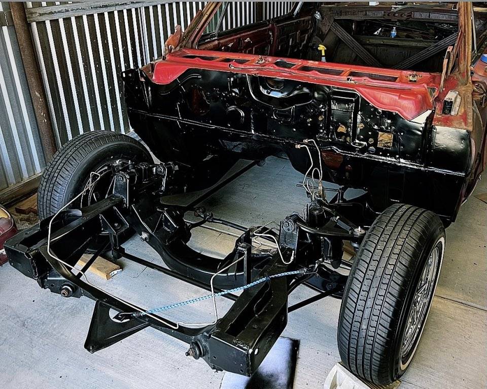

Not to brag or anything… but I think this car is beginning to look pretty DANG GOOD if I’d say so myself! Very proud of the progress that’s been taking place on this 68. A striking difference now versus how it looked when I bought it.

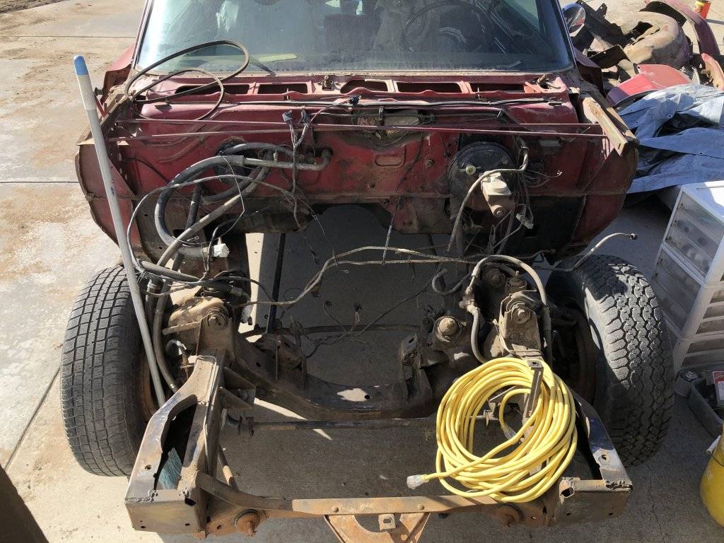

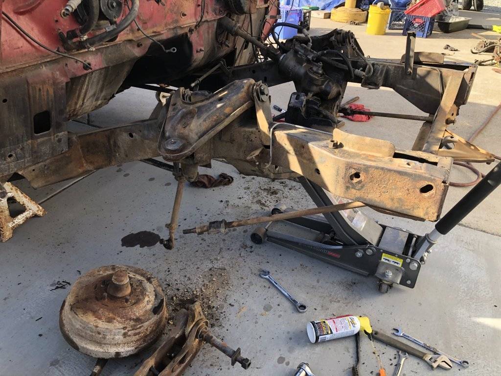

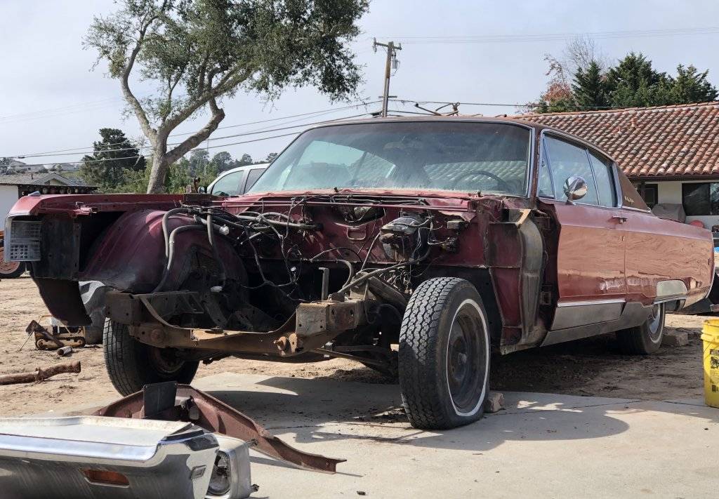

Here’s a reminder of how crusty this thing was when I first took it apart.

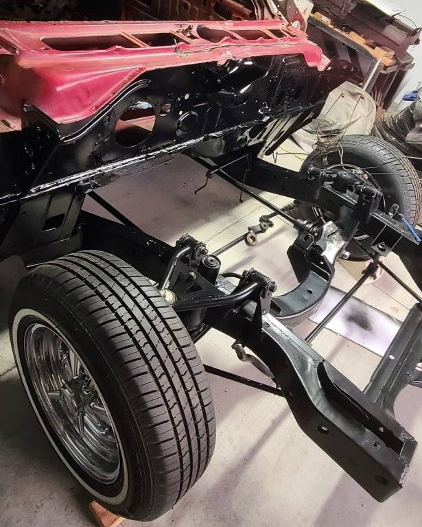

Great progress Isaiah, give us some details as to what all you did. Obviously a good cleaning and power wash, did you paint or Powder Coat? Also did you reuse the front drums or did you do a disc conversion? Come on Isaiah, get with the program. Lol

Looks great! Some real progress there. I'm wondering why you choose to have the brake lines where they are, rather than in the stock position close to the frame.
Thank you so much! I actually did the frame before I even owned a power washer, would have been a LOT easier! I scrubbed that thing for like a week with a wire brush, air sanding tools and by hand in hard to reach places. Then, I used a powerful degreaser as a last step and a good wipe down / scuff before paint. I had contemplated powder coat, but decided to go with Rustoleum Canyon Black (satin.) I was VERY skeptical at first, but a friend of a friend is a car restorer himself and he uses it on his frames and engine compartments. They have held up against the wear and tear over the years, and best of all - it is very easy to touch up areas that may have gotten nicked or scratched!

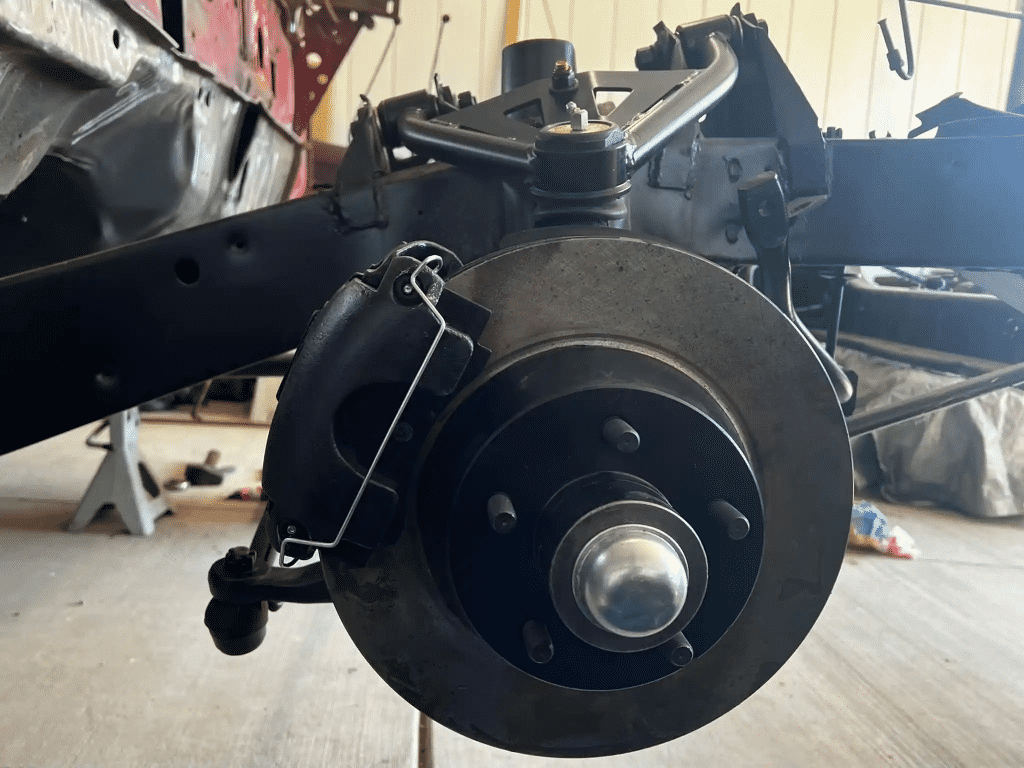

Initially, I did rebuild the drum brakes - but as time went by I started thinking of real life scenarios. I was actually in a car accident last December also, and totaled my truck. It really got me thinking of how I want this car to be safe, and comfortable to drive. Thanks to the forums I was able to do a '69-'72 disc brake conversion! I was really going after the '73 conversion with bigger spindles for more popular rotors, but they proved really hard to find. I rebuilt the braking system myself, save for the '65-'68 Bendix brake booster which I had Booster Dewey rebuild. It brings me good peace of mind knowing she'll be able to stop on the dime if ever I'm in a emergency stop situation!
Thank you! The brake lines are actually just pulled up and out of the way for now, they will go back to their factory position when I button things up real soon.
Here is a pic of the new, upgraded disc brake system using 1972 components. Rebuilt the calipers myself, and sand blasted / painted everything else. Oh yeah, also have Firm Feel tubular control arms on now too! Was lucky, and got everything as a complete kit (except the brake booster) from a fellow member of this forum.

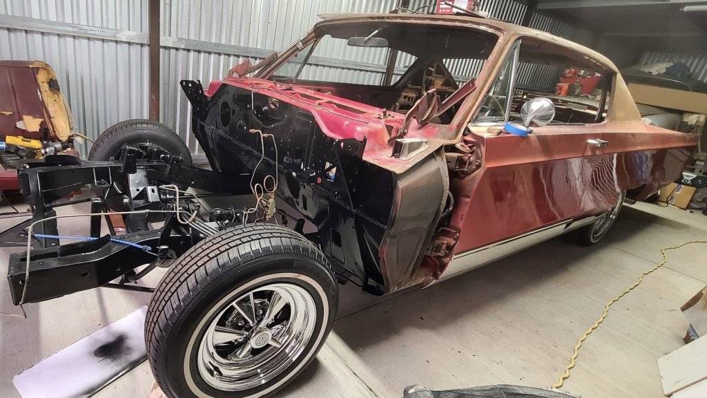

Moving along nicely and looks good, but I gotta ask. What made you choose to do the firewall in black instead of keeping it body colour?
It was a hard decision, and I really wouldn’t have preferred it myself… but this car is never going to be a full “show” car (¿maybe someday?) It’s just going to be a REALLY clean cruiser. My idea behind flat black, is the fact that it is easy to touch up in case anything ever gets messed up. Another thing too, is that it will showcase how beautiful that rebuilt and dressed up 440 is going to look!!! Here’s what it looks like so far… Seam sealed and painted in satin black.
Also, I can’t decide on a body color QUITE yet, so I am going to wet sand, buff and polish the paint and seal it with clear coat to preserve the original PP1 paint for now! It will be a nice “work in progress.” I’m going to paint the roof in silver most likely and give her a attitude height adjustment … I’m a big fan of the 70s lowered look with a slight rake. Not too radical but just to set the theme just right for this!
