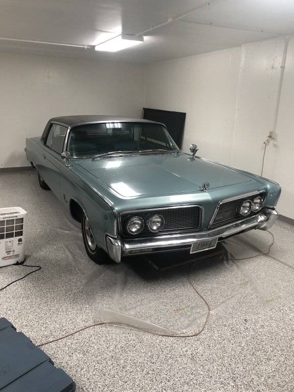

The paint on the hood of this car was applied at Jefferson Avenue. To my eye, the right rear quarter panel looks closer to the factory color than any of the rest of your car.
It Also looks dirty and oxidized, it might lighten up if it were color sanded and rubbed out.
