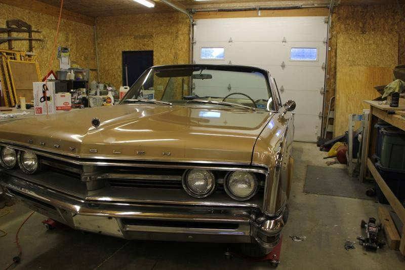

I personally buffed my 300 which was a single stage original metallic gold. I had no issues burning through paint and was happy with the results where I had good paint, but I ended up repainting because of the body work and trunk lid was a shelf for years, so it was toast. I would not recommend this if this is your first car things can go terribly wrong, because there is a bit of art to it.
I just found this photo the driver side was buffed out the other was the best I could do by hand. My car paint was really bad though it sat for 32 years and you couldn't even tell that is was metallic until it was buffed.

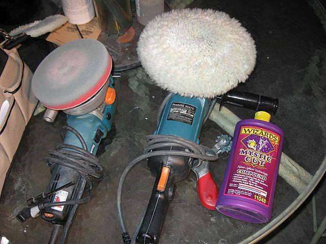

Below are my tools. To buff/polish is the Makita 9227 with wool pad and to remove swirls is the Makita B06040 with either orange or red foam pad. I sue Wizards for polishing and Sure Finish for swirl removal. You can tape the edges which I rarely do unless there is another edge nearby. I simply polish off the edge rather than onto the edge. Just finished the hood of a 91 Mazda 626 where the clear coat failed. Prepped, repainted bc/cc, color sanded with 1500/3000 and then my two Makitas. Start slow at 1000 rpm with some pressure and as you see shine in the section you are working then speed up to 3000 rpm with a light touch. I use a water spray bottle at that point to renew the Wizards Mystic Cut.

Now take note that my two machines do different things. The 9227 is a polisher and I also use it to strip paint either via 80 grit or a 3M removal disc. The BO6040 is an orbital polisher which has two settings unlike most. One setting is your familiar random orbit for laying down wax. The other setting is forced orbit which is what Robert is using to polish a little more gently that with the 9227 and wool. Random orbit could take to the end of time to remove swirls while forced orbit could do it in a few minutes.

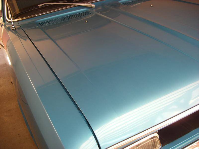

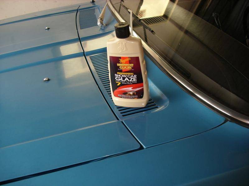

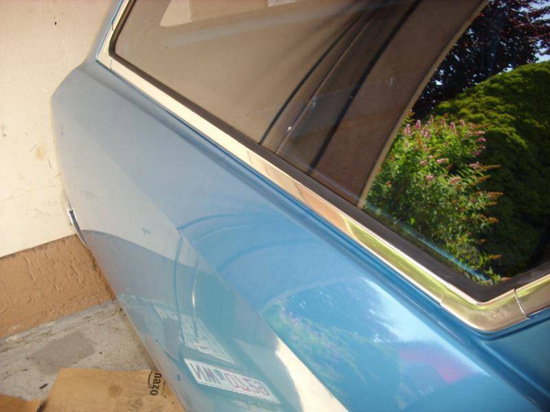

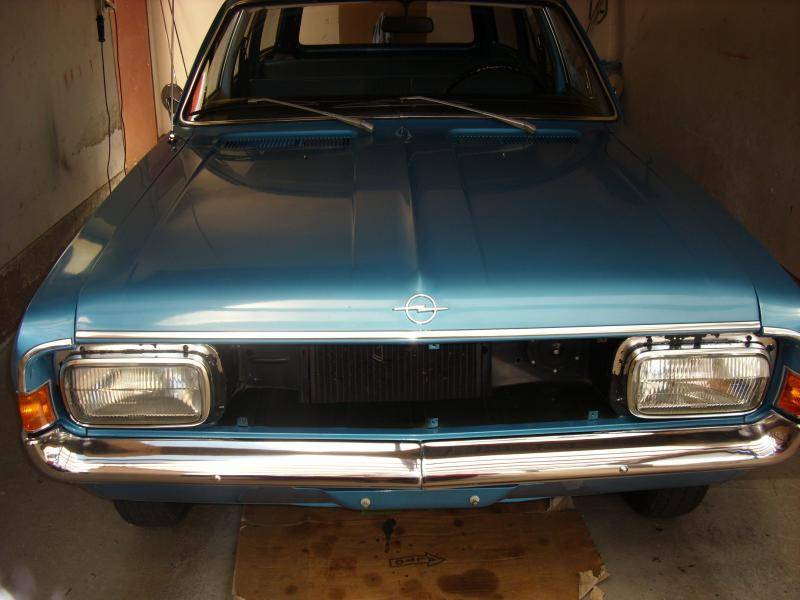

No Mopar, but problem's the same. I went for Starters with polishing by Hand and the recommended Show car glaze no.7 as was done in above link. Before that I took a clay bar from German Sonax Co. to remove dirt, there wasn't much on as the Color of the bar only changed a Little. Polishing afterwards resulted in a real shiny unclouded Surface except for the Problem Areas Hood and Roof, it improved considerably but the only Chance of an even greater improvement before putting wax on will be with machines. The stains on the Roof from the fire sprinkling system however go all through the old paint, no Chance to get them removed.
Great looking car, Klaus. Love the color! Lets see more of it when you get a chance.

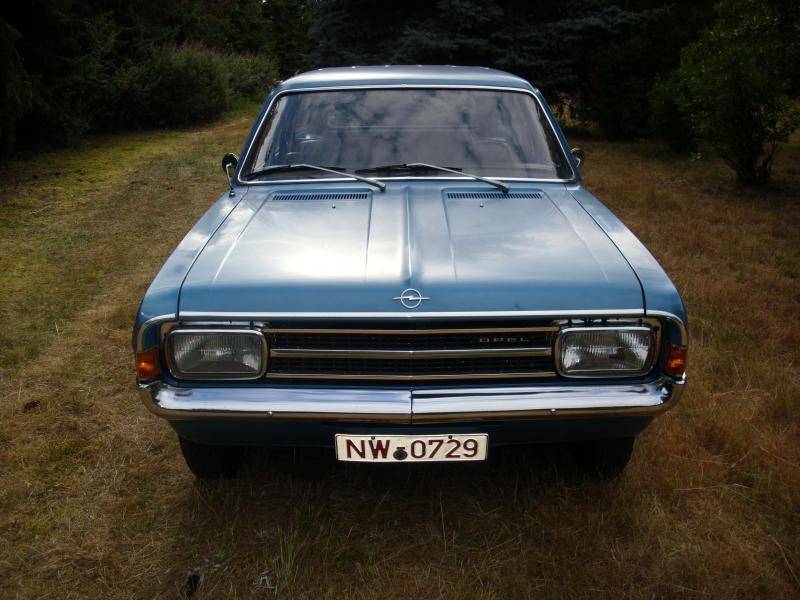

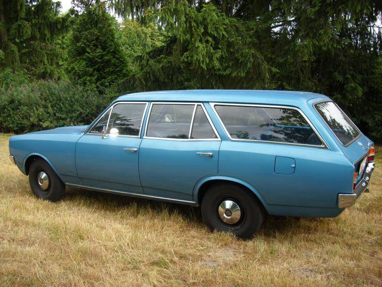

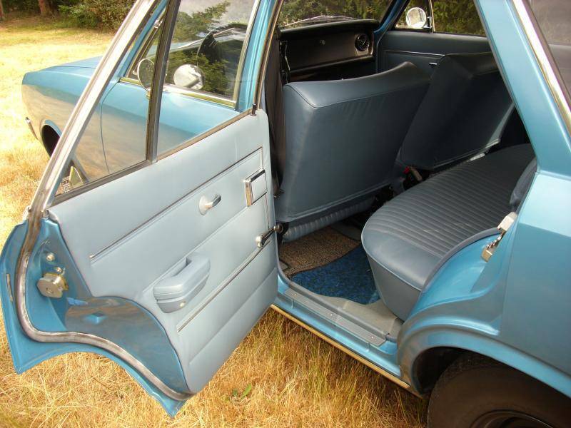

It's a 71 GM Opel Rekord CarAvan, something like a Bel Air Townsman would have been in the US and design is influenced by US GM for sure. No factory Options but extra cost met. paint. Color is called Monza blue met. and I would bet if you analyze it, it would turn out to be a match to some US GM Color, probably the best one still around in unrestored 27k mls condition and original single stage met. paint. Loved it eversince I first saw it 8 years ago.
