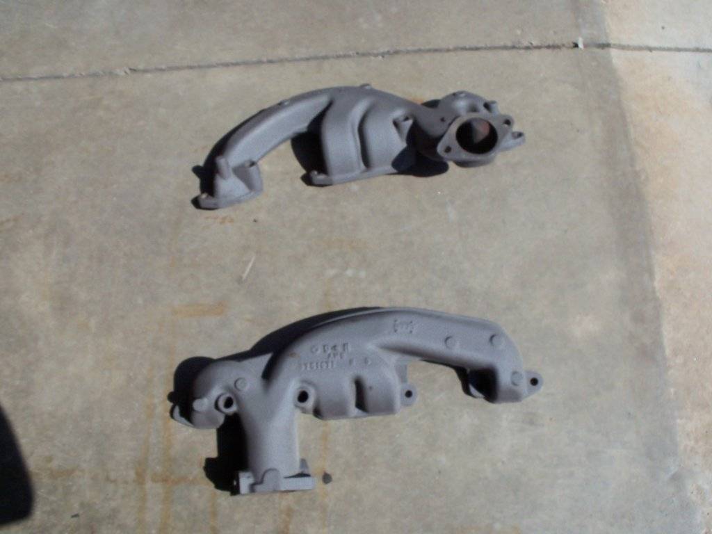

I did not use slip plate but used Eastwoods single pint manifold paint done by brush.
I sandblasted and prepped the manifolds prior to painting and appear to be holding up...
