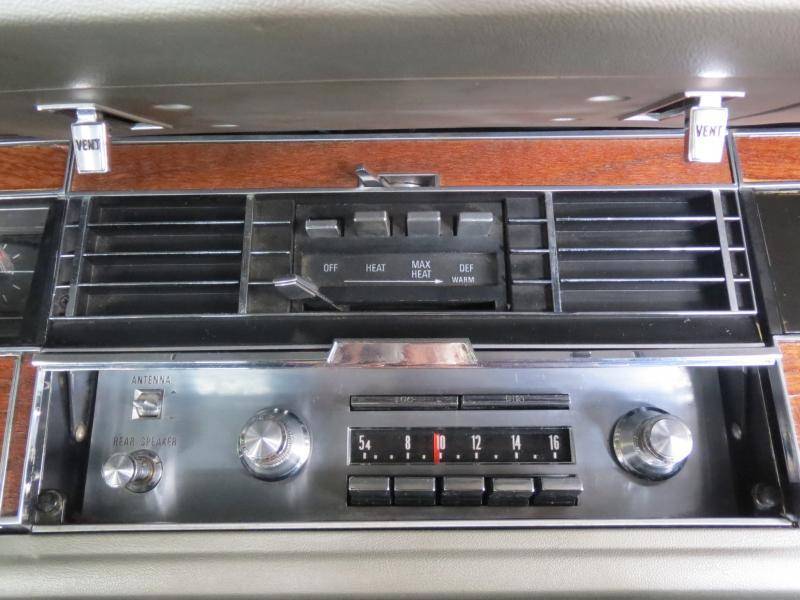

Here's my dilemma. Christmas is coming, cars in paid storage and I need an after
market, dash mounted radio to put on my Christmas list. Don't know the spread
on the knobs or the size of the dial head. Need help really bad cause I don't know
what will fit. What do you guys use? My car is a 65 Fury III. If some one could
get the necessary dimensions, I could probably do the research but, like I said
the cars currently unavailable. that's really the sound of silence. Thanks!

Doesn't the bezel cover part of the radio face? If it does you will not find an aftermarket radio to fit without cutting the dash.
Alan
Find another 65 Fury factory radio and send it out to be converted to am/fm-CD with an aux to plug and play a mp3 player. It'll fit perfect.
Or just convert your original.

I had the am radio in my'67 Imp converted to am/fm/mp3 and this is what it looks like now. The foot operated search button still works flawlessly with it.
The radio automatically powers up on fm band. To change to am you just turn it off and back on again and do the same when you want to go back to fm. It's really a very simple set up and with all the new modern speakers, it sounds great.
