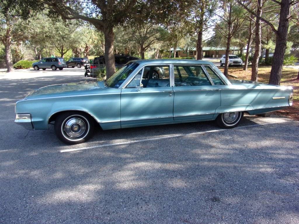

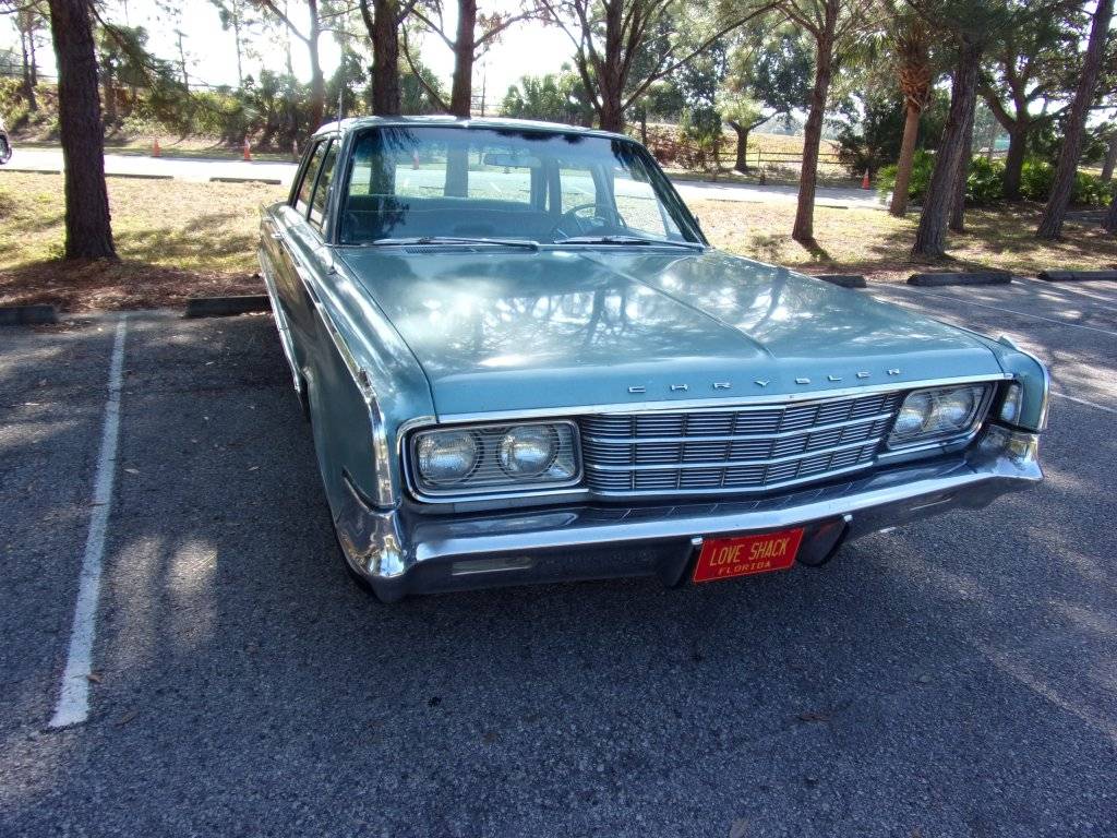

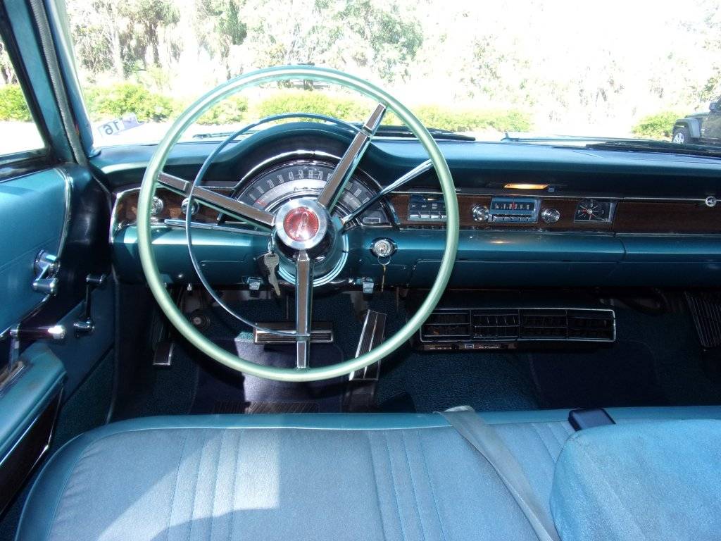

Hello fellas and fell-ettes,
I need suspension parts for my 65 New Yorker, namely ball joints and control arm bushings. Can anyone refer me to some place that sells this stuff? Many thanks as always for your help. Rich in Tampa

Nice Town Sedan! - Firm Feel is a good choice, there is also Espo Springs & Things..... replacing those joints and bushings REALLY improves the handling on these cars......
