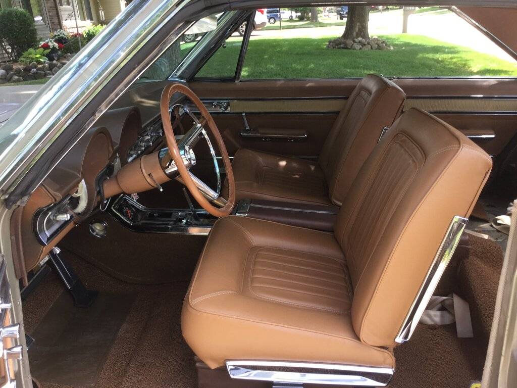

These are the seats along with the rear bench I had done last year. SMS wanted me to remove my covers and send to them to use as patterns. They have no 65 Monaco seat patterns.
Instead I hit a recommended local shop. After all I do live in the heart of car central. This place is in the shadow of the CTC and does some custom interiors for FCA. We found a near perfect color and grain match from their swatches and available locally. Most custom shops just make their own piping out of the same material rather than solid vinyl piping like the factory that never really matched the tan seats. I bought the bucket foam buns and they provided all the rest, cleaned and painted the frames and springs, for completely finished seats. For less than it would cost to have the SMS material installed. Whenever it arrived knowing SMS is very busy.
As far as I’m concerned this stuff looks just like the original vinyl but superior as it feels butter soft like Chrysler's famous top grain leathers.

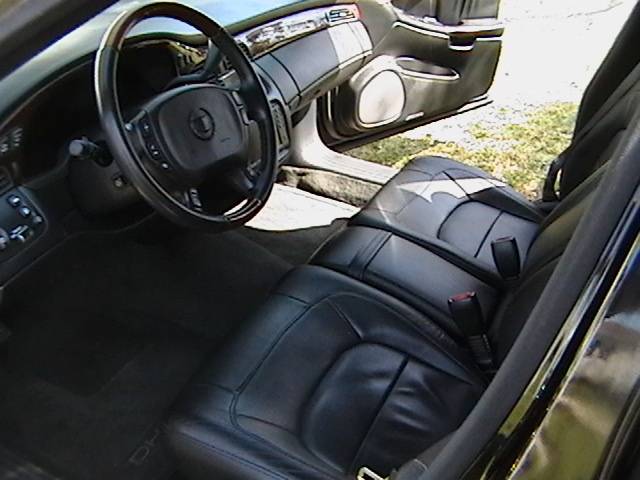

I am putting 2004 caddy seats in my 57 Dodge :) Im getting heated, wish i would have gotten cooled seats also. Talk about comfortable, i could move in...

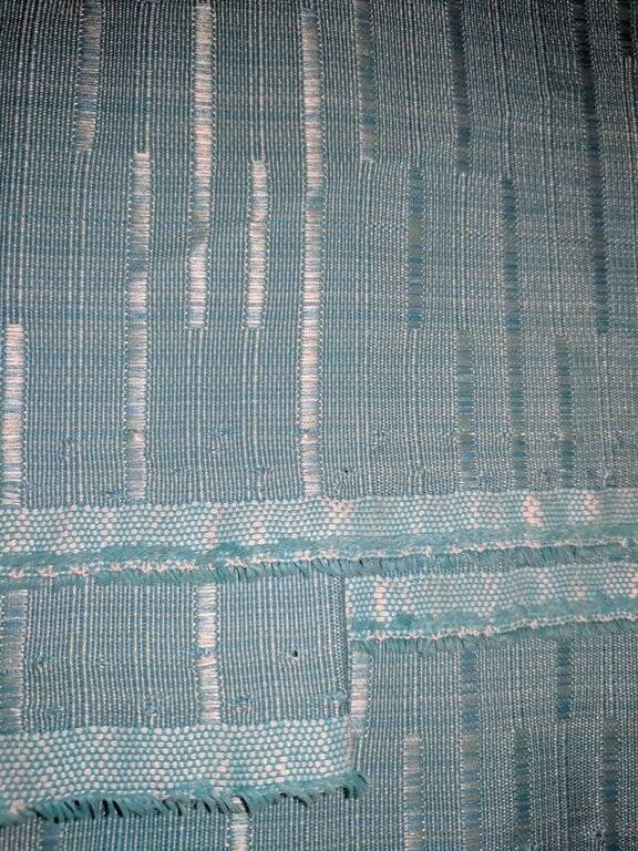

Im making my own door cars and i have marine grade vinyl. Here is what i will use with my center section for patterned inserts.
and here is the 2004 caddy Deville seats(it looks like a bench seat when console is down).
But of course im a custom 1957/8 Dodge Regal Lancer
