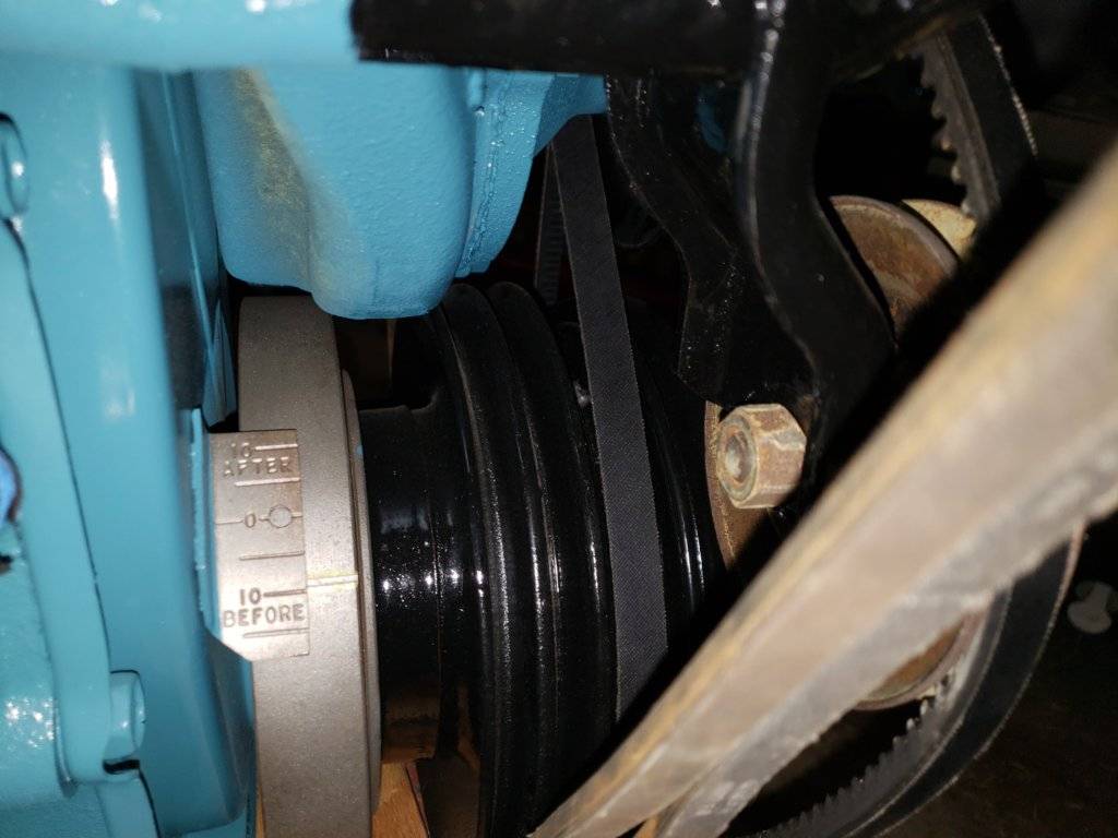

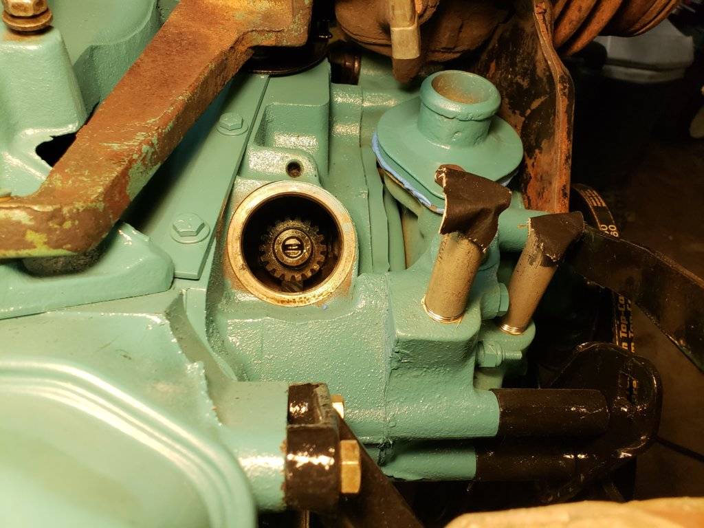

i need to stab the distributor gear. the book says set the timing to #1 TDC / "0" on the timing marks, and then set the drive shaft gear so it is parallel with the centerline of the crankshaft. the reference pic makes it look like the distributor slot is 12/6 position when standing at the front of the motor.
so my motor is set at -10TDC right now. do i still follow the book procedure, or try to guess 1 tooth back, or whats my move.
