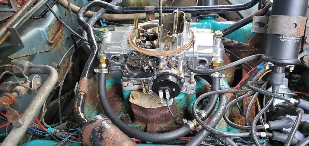

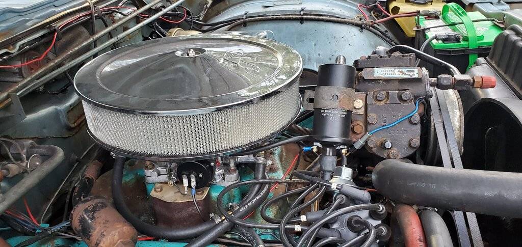

My first thought went to a possible bad ignition coil and then I noticed in your pictures that the coil is mounted on the A/C compressor with the terminals pointed down.
I once read about how the ignition coil isn't 100% full of oil and it may effect some coils to be mounted "upside down", particularly when the coil isn't intended to be mounted that way (like in an old VW for instance) . That came from directly from a ignition coil manufacturer, so that's a pretty good authority.
So... Since I see the mounting AND you are having some issues that might be coil related, I would say an easy thing to try is to mount the coil where it belongs on the manifold and see what happens.

The coil mount is wrong and that needs to be fixed as noted. Check to be sure that whoever updated the ignition also installed an electronic voltage regulator. Electronic ignitions does not play well with the old mechanical regulators because they generate lots of static which destroys electronics. Take the fuel filter off and blow it out, if it is full of rust or other crap, your problem is likely fuel delivery related. If the fuel pump was not changed after the car sat for ten years, it is also suspect. Ethanol blend fuels degrade quickly in cars that are not driven and can leave a big mess in the fuel system and the degraded fuel also eats up rubber parts like the fuel pump diaphragm and the fuel lines.. There is a filter sock on the fuel pickup in the tank and those often get clogged if the tank is full of sludge. These are some things to check.
If the problem is fuel related, you probably will not be getting a squirt of fuel from the accelerator pump in the carb. Remove the air cleaner and look down the carb throat to see if you are getting fuel when the throttle linkage is moved the next time it quits. No fuel, the carb is likely dry from fuel starvation. If the coil, the ignition module or control is bad you will not be getting spark when you remove the coil wire from the distributor and crank the engine. Place the coil wire about 1/4" from a good ground and you should see spark. If not your problem is ignition related.

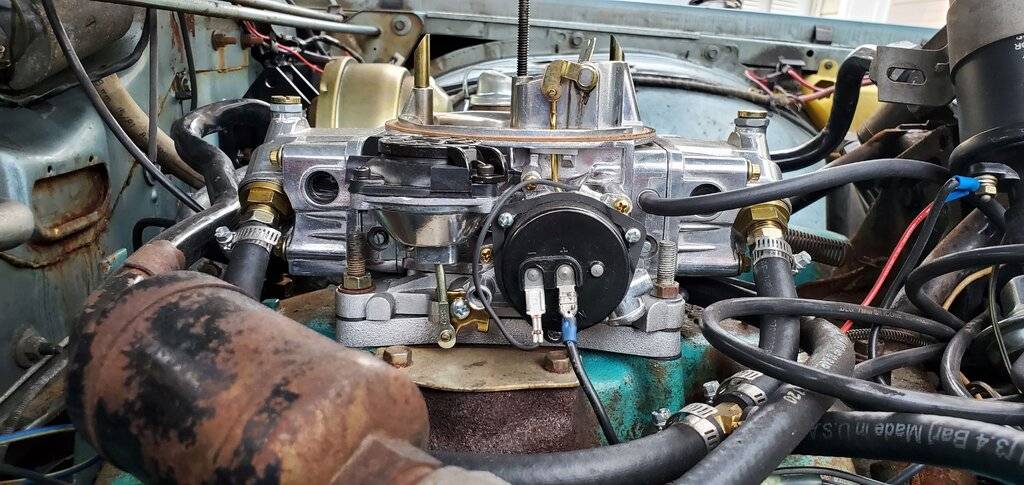

sounds like your gas line is to close to a heat source and is perculateing your gas once it gets hot enough.....is fairly similar to a faulty fuel filter only once the gas cools down your fine to go again....if nothing else easy check to rule it out..bin der done dat
One other thing that I notice is the rubber fuel line is sitting right on the exhaust crossover. It may not be your issue, but it's still not where I would want it. Plenty of steel line kits for that carb out there, so it's an easy fix.

Since you have electric choke already, I recommend blocking the heat crossover since it is no longer needed.
It will drop the temps at the carb by over 110 degrees. You will have to pull the intake however but worth the trouble.
Did this to both the 66 300 and 68 Newport.
Also use heat sheathing on your fuel line.
One final recommendation is a 1 inch carb spacer to help isolate the carb away from heat. Not necessary but will start first click of the key hot every time and gain some bottom end-- not much but will be noticable.
