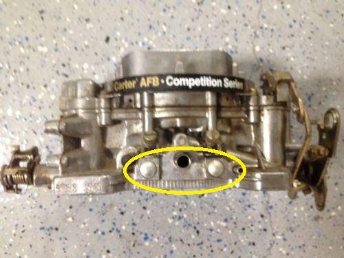

Many thanks to all who provided input. BTW . . . can anybody tell me what those little brass block-out plugs are for? I searched the FSM and a bunch of other AFB reference material, and I couldn't find any mention of them.
If you mean these, they are to cover holes that were put in the side to facilitate machining of the carb. The passages are drilled/machined from the side and then the access hole is plugged. Usually they are just an aluminum expansion plug.
Some guys pull them out during rebuilds and sometimes they just fall out. As Cbody67 says, the ethanol gas might even bring it about.
I think these are the ones you want... You might even be able to find a similar generic expansion plug.
Aluminum Expansion Plug 5/16
