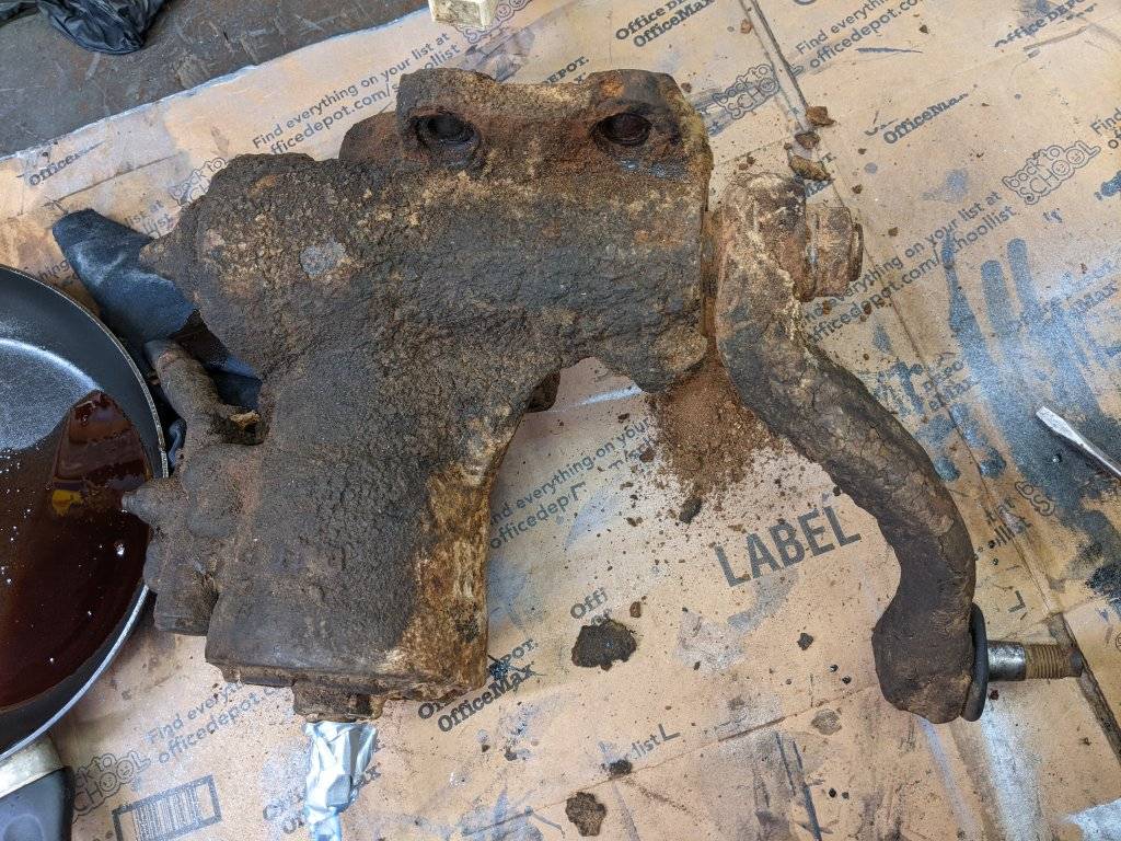

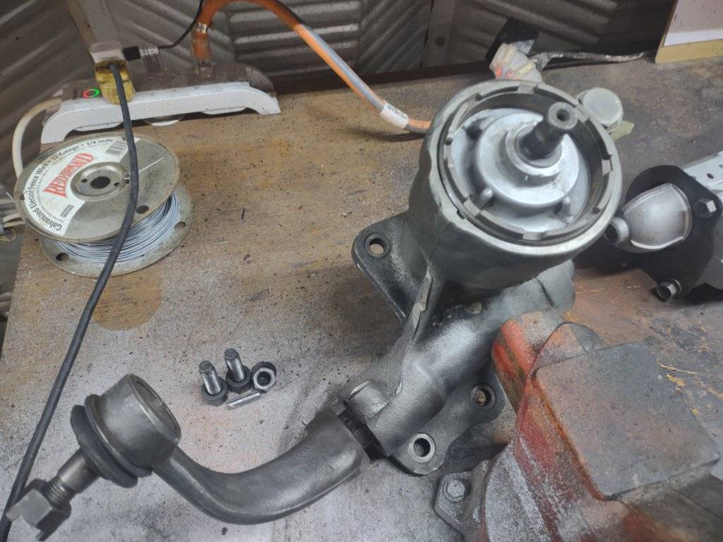

Well had to remove the steering gear. No means of extracting the worm shat seal otherwise. Had to unscrew the entire top plate to get to the seal and no mention in the fsm of the needle bearings just under the seal. Fortunately it was on a clean towel and i didnt lose any of them.

Your gear looks twice as bad as mine did.
