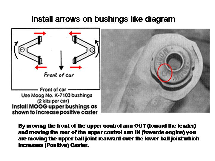

stock ones or the offset ones, anyone have a issue not getting enough camber on stock
on my b body i have the tubular FF ones. and to my knowledge they are made to give more negative camber
thank you
on for Abodiesony there a post on it and says to install in certain way to give pos camber
why would you want that, im thinking neg camber . so would you install the bushings so it moves in arm towards engine?
It is my understanding the offset upper control arm bushings are to compensate for "sag" of the structure the upper control arms mount to. I first heard of this situation on big block Chevelles of the early 1970s, but later discovered such also happened with 1955 Chevies. So the offset bushings have been around for ages, for many cars. In some brands of suspension bushings, the offset ones are all they sell, last time I looked.
Many aftermarket upper control arms, especially the tubular ones, are engineered to provide more positive caster than the stock ones can provide. Caster and camber are related, but different "angles".

this seems right but , wondering can i achieve with stock bushing .5 of camber and 2.5 caster
I would suggest you look for the Chrysler MasterTech program on front end alignment. It illustrated ONE great thing about Chrysler front end geometry that Ford and GM do not have. Camber change in the corners. At stock settings.
In a left hand turn, for example, the outside wheel goes into negative camber, as the inside wheel goes into positive camber. As the car leans, the tire sidewalls still remain perpendicular to the road surface. With the use of a front sway bar, less lean and MORE bracing of the sidewall against the cornering loads. With A GM or Ford front suspension, no camber change so as the car leans, so does the outer tire, into effective positive camber.
On the GM front suspension, adding caster to the mix gives something of the above-mentioned Chrysler effect to the actual geometry. Better bracing the tire sidewall against the cornering forces. On my '77 Camaro (F42 w/WS6 sway bars), I told my alignment guy to "max caster" (to whatever value he could get), minimize camber (in specs), and "0" toe-in (for minimum tire wear and help maximize fuel economy). To me, these orientations can work for pretty much every car on the road. BTAIM
