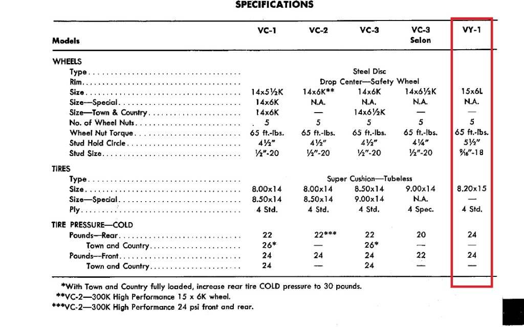

Here's a screen shot from the wheel section and I've highlighted the Imperial wheel spec. As you can see, the stock wheels were 15 x 6 with a 5 on 5 1/2" bolt circle. Yea... 5 1/2 bolt circle. So, you might have to start looking at truck wheels.
Of course they would… not gonna make it easy on someone 60 years later trying to find parts..Imperial's had the own wheel size, bolt pattern, offset, the works. Steve Magnante on Youtube. He has lots of Junkyard Crawl episodes on Imperials. Check them out, he covers their specific wheels in nearly all of them.
