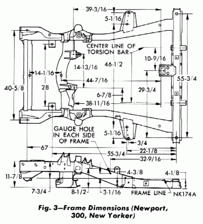

I couldn't find an online '68 Chrysler service manual, so I'll compare the frame diagrams from the 1966 manuals. Dodge vs Chrysler. If you can see a difference somewhere, let me know. Otherwise I remain convinced that Monaco/Polara shared the same stub frame as all the Chrysler's, for at least 66/67/68 and probably '65. I'm guessing Fury is going to be different only because of the shorter rear torsion bar socket.

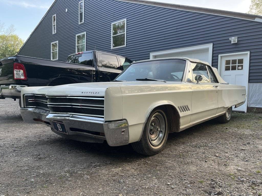

Here’s my car… the body is pretty nice. I kinda got swindled a little when i bought it unseen. I got lots of pictures so i knew the underside was going to need some work… however, when i slide under it and started poking around… my finger disappeared through spots that looked good in the pics and i wondered what was holding it together. It won’t pass NYS inspection… so i can’t even drive it… So now i need to grit my teeth and fix it.

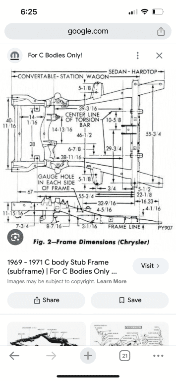

I’m only seeing like 1/16” differences in a couple spots with the 69-71 300 stub frames compared to the 66 Polara above.., so i have to assume 68 was the same. Looks like the range might go from 66-71 now.
Some of the 70-71 Stub frames are a bit different in that some were made for rubber mounting to the body and there's extensions off the rear. Exceptions to this are convertibles and station wagons. The 69 and 70 Plymouths used a shorter torsion bar so that won't work either. So maybe a '69 Chrysler or Dodge or a '70 Chrysler or Dodge convertible or station wagon. You can see in your diagram the difference between the sedan/hardtop and convertible/station wagon.

The MyMopar site does not have a '68 Chrysler service manual as far as I've seen. Nor '67 if I recall. It does have '66, so that's why I compared the 1966 frames between Dodge and Chrysler. If you look, the diagrams both have the same code (NK174A). I also couldn't find a '68 Polara/Monaco manual, but there is a '67, and it shows again what I think are exactly the same numbers, the frame diagram is coded as NK174B.

Within the C-body platform for Chrysler and Dodge, MyMopar.com does onto have everything for each one, but a representative number that can be used. The particular "Slabs" platform you have went from '65-'68 model years with the body shop diagonals being the same. '66 is good as it was the 2nd year of that platform series.
If you desire "a second source", look for the charts for the body shop frame machine equipment companies who had such specs, too. Might be something online, too, just verify WHERE it came from.
Otherwise, put your car on 4 jackstands (on a solid and level shop floor), drop some plumb-bobs and make your own "map" off of your car. Then see how they compare to the FSM maps.

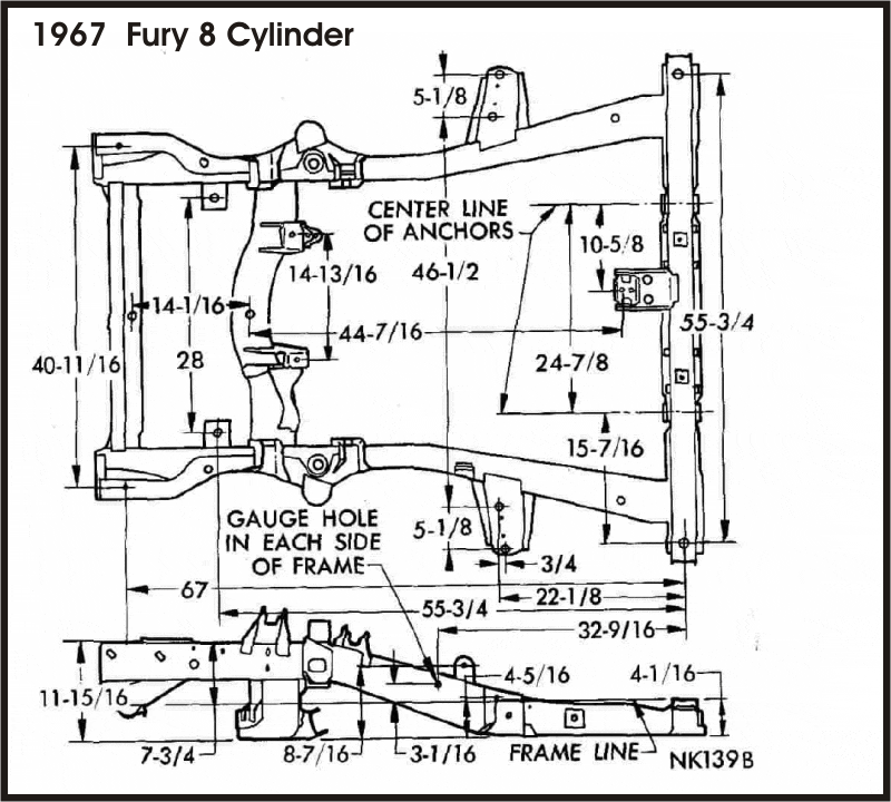

This is a 1967 Fury frame. It came as slant-6 and V-8. This is the V-8. Note that it has diagram code NK139B. The most obvious difference is the shorter rear torsion bar anchor sockets. You need to use 44" torsion bars for the Fury. Not 47".

I was wondering about the fury… thank you.
