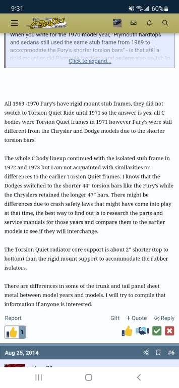

I thought 71 thru 73 Plymouth would work. All are torsion quiet. All have same shorter 44" torsion bar. At least according to Firm Feel, 1965-1973 torsion bars are same. What makes 1973 and possibly 1972 different? thanks, Ben

I just knew 71 would work and not the 69 or 70s after reading more into it like you posted about the 44" torsion bars. Looks like 72 and 73 Plymouth and Dodge will work Chrysler kept the 47" torsion bars.
