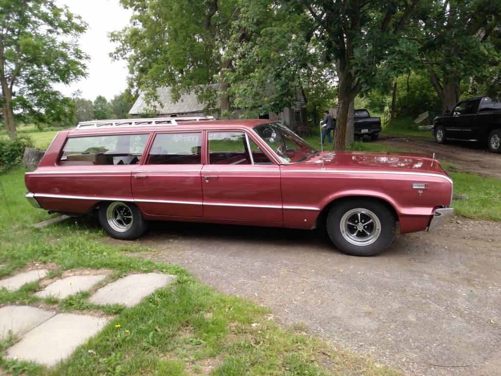

We have 15x7 Magnums on our 65 wagon with 235/70/15 tires.

Very nice...great looking wagon!...and thanks for the photo and also for mentioning your tire size.
Two decisions to make yet...
1. 15x6 or 15x7...
2. 225/75r-15 or 235/70r-15 (a 235/70 is a bit smaller in dia. than a 225/75)
I had 15x7's with 235/75r-15's on the front of my old 68 Monaco 500...when I turned hard left, the tire rubbed on the frame. Therefore I'm leary of going with anything larger than a 225/75r-15. Do you have any interferences with your 235/70r-15's when turning?

None that we've noticed. Much more stable at speed compared to the 225/75/14's it had.
235/70/15 is 28" tall.
Kevin

My 300 has 245/60-15 on 7". No interference issues. It's darn close at full lock, but close only counts in horseshoes and handgrenades.

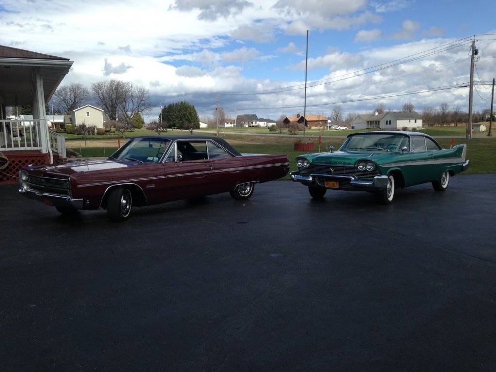

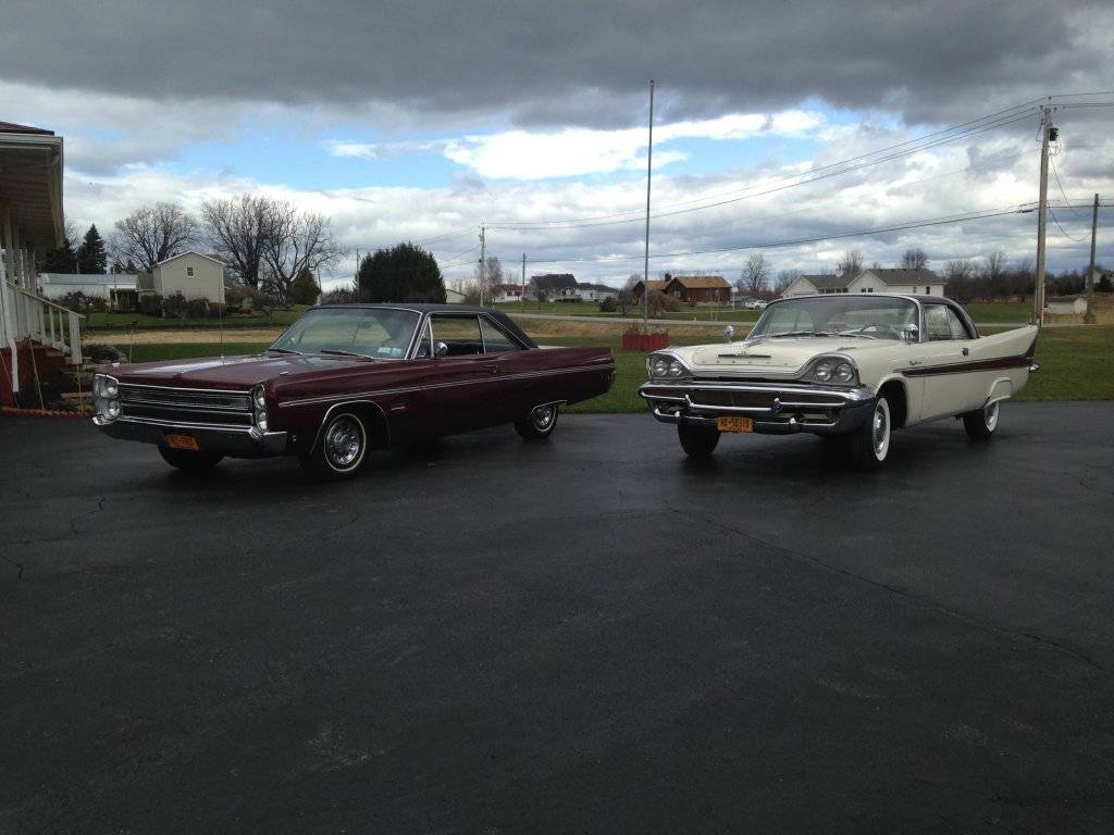

Heres's a couple of photos you all might enjoy. A small token of my appreciation for all the help you guys have given me. I got the cars out in the driveway together a couple of days ago....before I got the 68 Fury up on jackstands to do the brake work.
