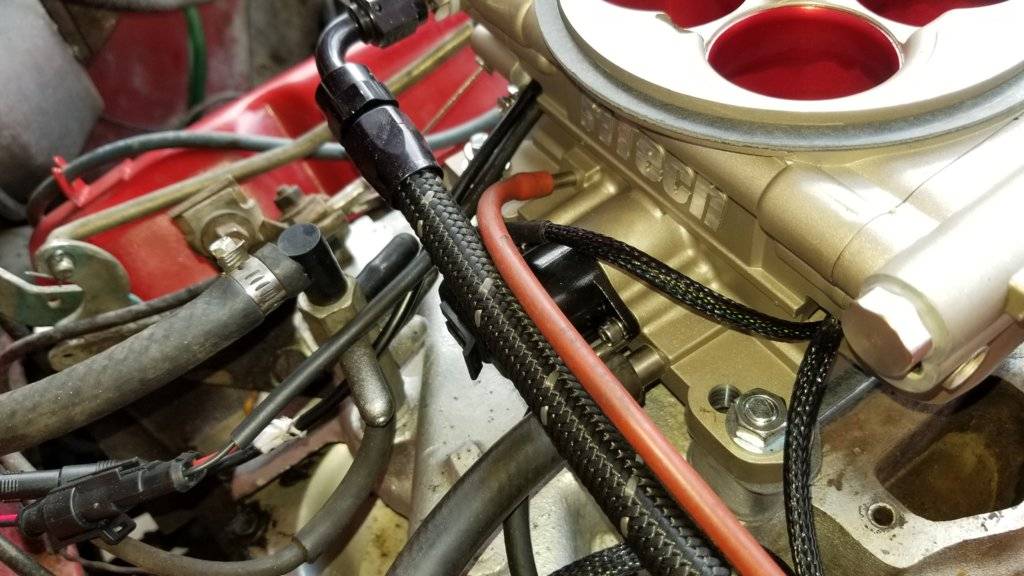

If that the Orange one going to the distributor it looks right. Just make sure it's ported, no vacuum at idle.
