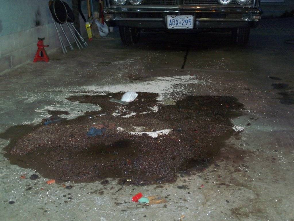

I am now up to three 727's where they have puked their fluid out on the floor. Cars that have sat, and then run, and then the pan gasket goes out! I am starting to learn my lesson!
Well, I am now up to four cars that have done this. I went home to SD and the latest acquisition, the 73 Imp now dumped its tranny fluid all over the floor. The next Imp will get a diaper when I park it. Sheesh! I have two new pans, and several types of gaskets, one a rubber gasket from A&A Trans. Now to get them on a trailer and off to be repaired.
