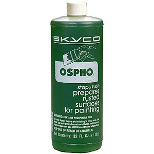

In the trunk or anywhere there is just surface rust which always have tiny surface pits. So I strip paint off with a 7" 3M stripping disc, then wire wheel the affected area and finally rub deep into the area some Picklex 20 and let sit for 1 minute. After that I epoxy prime with a non-acid epoxy primer.
I agonized over all this rust converter stuff, did a ton of research and decided that all those products out there is simply, in one fancy form or another this chemical.
I used it. IT WORKS!!!! It's cheap. Did I say IT WORKS?
http://www.amazon.com/Skyco-Ospho-S..._sbs_60_2?ie=UTF8&refRID=0S3HWAP4D0RVN6YKB7H9
After a vigorous workout with this first of course:
Finally, encapsulate the treated area with an OIL BASED paint such as Rustoleum.
Well if it's good enough for you ,Stan it's good enough for me I will look it up and maby try it .I have used a product like it called ,Kurust I don't know if you've heard of it They may be similar I don't know , I suppose these products are all alike ,
Basically you want a liquid solution of phosphoric acid in the highest concentration you can buy, usually 85%.
Basically you want a liquid solution of phosphoric acid in the highest concentration you can buy.
Ok I need to study more on this I want to get the ,Right rust inhibiter i know it won't cure it but it should keep it at bay for a while . Cheers
You're paying WAY too much for it. You can get the same thing at Home Depot for 1/4 the price. They call it prep and etch, in the box stores it's sold as concrete etchant, $15/gal. Same stuff, same instructions, read the MDS, I know you do.
http://www.homedepot.com/p/Klean-Strip-1-gal-Phosphoric-Prep-and-Etch-GKPA30220/100406369
