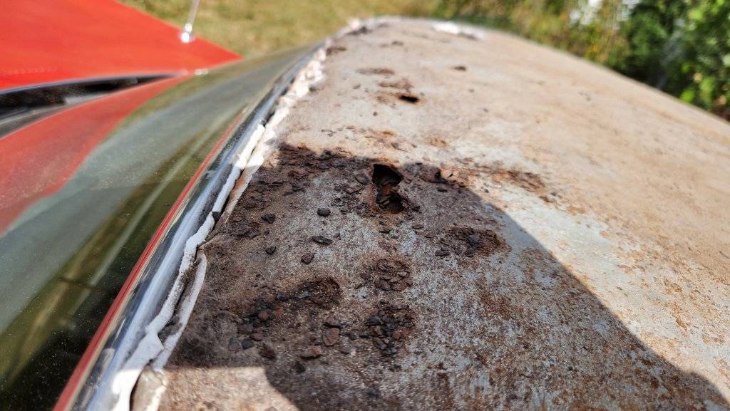

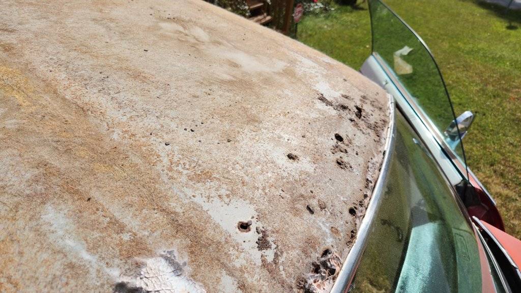

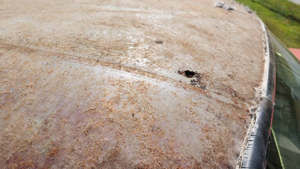

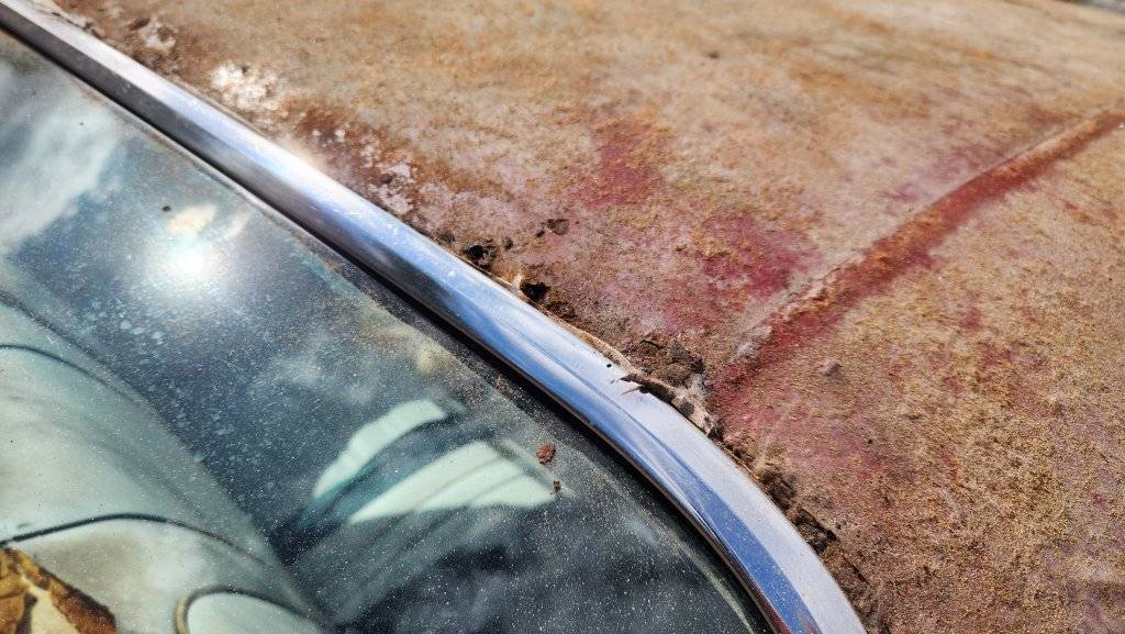

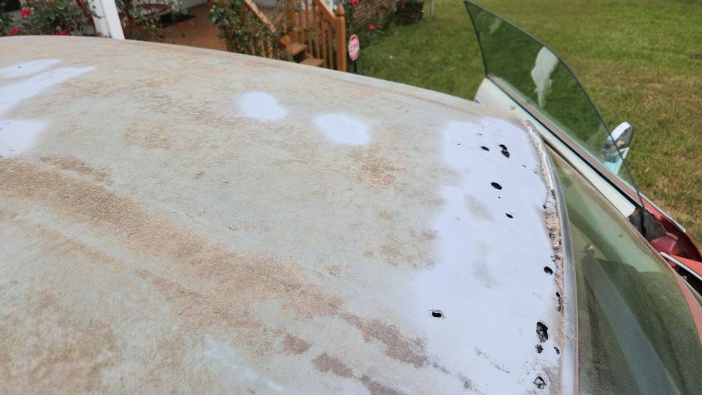

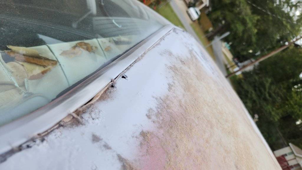

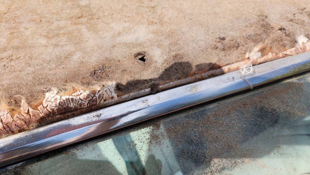

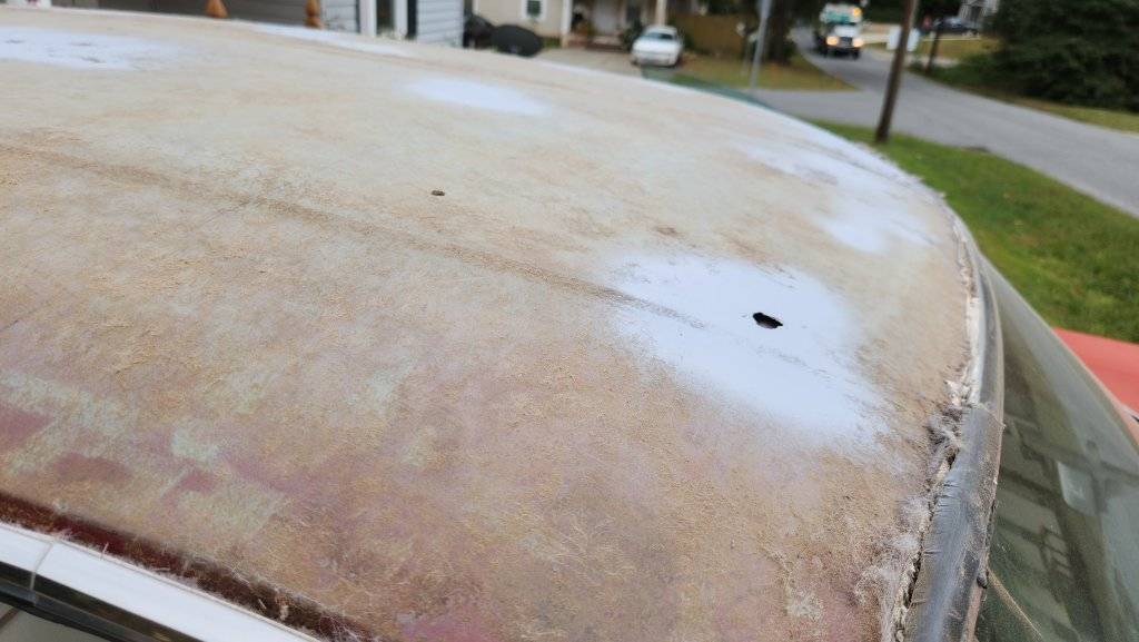

So I pulled the trigger a couple of weeks ago and pulled the vinyl off my roof. It wasn't pretty. Vinyl covers a multitude of sins.
I hope I managed to at least stop the spread with some sanding and primer, but obviously gotta patch the holes. I know about as much about body work as any guy who's watched a few YouTube videos to be honest and not financially blessed at this point to leave it to a professional. So...
I bought some sanding blocks, long-hair fiberglass Bondo and adhesive body patches. The idea is to sand it down to bare metal (or nothing), primer it, stick the body patch on and then the Bondo. I'm not looking for pretty at this point, just stop the bleeding and minimize the leaks I already have (in addition to Flex Seal around the front and rear glass)
So for the Bondo, can this be done from the top (i.e. without removing the headliner?!)? A lot of videos show things like fender and quarter panel repair, where you can put the patch behind the hole. I plan to stick it over the hole from the top and then bondo over that.
Pardon my ignorance, I'm still learning.

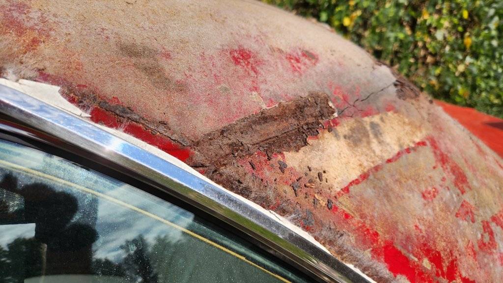

Just my 2 cents worth, but it’s not just about leaks or beauty. The roof panel is the major structure of a unibody. Once perforated it is no longer a sound structure. Consider a donor roof or extensive patches to weld in. What year and model are we looking at?
In one respect, I would say "Forget the fiberglass", figure out how to remove the cloth headliner, and put all of your patch panels on from the inside, where available, using panel adhesive on the cleaned inner surface of the roof panel. Rather than "body shop coatings", I might suggest a rust encapsulator coating, THEN paint and primer as directed.
In the case of the C-pillar/roof seam, knock out the "flakes" and work from there. Encapsulating and then plugging the holes, then prime and paint.
Trying to approach things from the outside only might lead to more issues later on, needing more repairs that are worse.
Might even use something like J-B Weld to plug the smaller, cleaned-off, then encapsulated holes might work, too? Using some of the stainless steel tape as a backing for it.
Bad thing is that seasons are changing so working quickly and efficiently can be important.

Having much experience with these cars, I'd expect that you have quite a bit more rust hiding down in the window channels, and it would be a huge and expensive job to completely repair all the rust permanently. These days, it's close to impossible to find a professional shop that wants to get involved with this kind of job, so it's really up to you to decide what you can do to preserve it as long as you can. The best favor you could do for the car would be to get one of the metal, free standing carports to keep it out of the rain as much as possible. Unfortunately, fusey's are leakers, and it's really tough to keep the water out of them.
Jeff
Also, I really don't think there are any "structural" concerns. The roof skin isn't structural on these cars. There's a very thick structural skeleton that runs around the perimeter of the roof and down behind the C pillars, and you don't have nearly enough rust where I would be worried about any damage to those inner panels.
Jeff

Sorry for your pain, vinyl tops were one of the dumbest options ever offered. Have you removed the window trim yet? Doing that may solidify the choice of repairs, I have a hunch it will be worse underneath.
