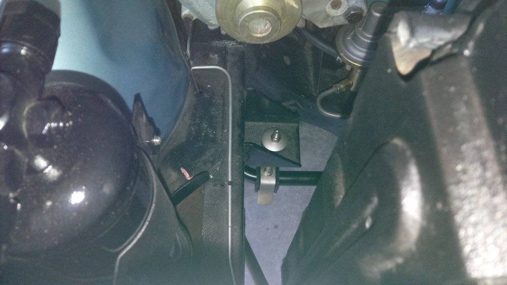

Yes; ADDCO makes sway bars for front and rear. You'll have to fabricate sturdy mounting points for the end links -some welding required- but they fit just dandy in my '67 Fury III. I'm glad I put them in, handling was improved a lot.

bushings from clamps to strut rod Mevotech 7064...they dont have the little extra tab like the original but they work...bushings for links to bar and chassis Mevotech 7061...Rockauto has them...the chassis had 2 brackets inside the rails that the links attached to...these would have to be cut off a sway bar equipped car or fabricated as they were just a flat plate about 3 inches square with a hole in the center and 2 triangular gussets to reinforce them to the frame....if you require more accurate dimensions and locations i could measure them for you...oh an a quick note about the previously mentioned rear bars from Addco etc...they don't clear TTI exhaust systems...think only the Firm Feel one does....and it appears that both the Firm Feel and PST front bars are designed to attach to the factory chassis mounts
