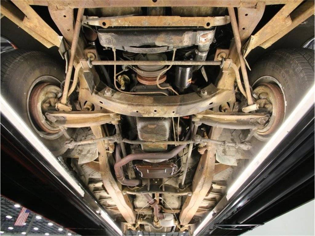

Here is a pic of one on a 64 Imperial. Not sure if all got them or not but somewhere to start. I think some station wagons got them in the early 60's too. My 60 parts book lists the bar and hardware part numbers but not which vehicles got them. My 60 Dart has the holes in the frame for bolt on brackets but I have never been able to locate the bolt in brackets. I too thought they should be easier to find. Good Luck! I don't think any of the aftermarket vendors have anything for these cars.

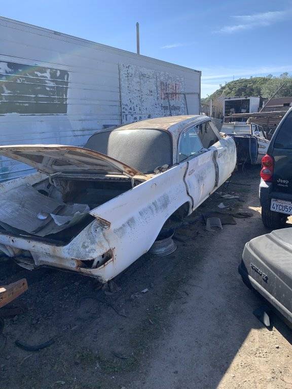

This 61 NY at a wrecking yard crushing out had the sway bar.
Jerk owner of yard would rather crush it than sell it
