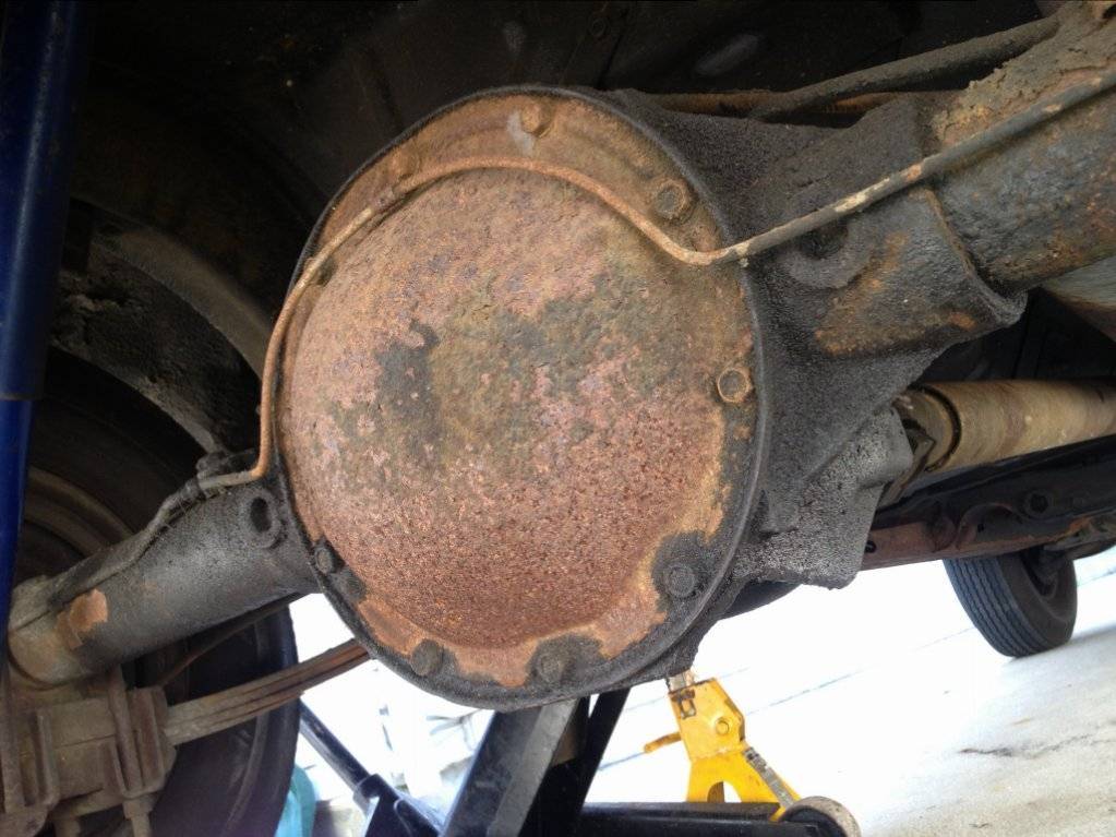

HI Charles, what size motor do you have in the 71? The reason I ask is I have a 71 Fury III as well and it has a 360, the rear axle assy is a 9 1/4 which is a good solid unit. Maybe a picture of the back of your axly assy will help us identify it?
This is a pic of the rear end taken a few years ago. My car is a 360/727 also. I got the 8 3/4 in with a lot of trouble but the ride is so quiet now. I almost passed on buying the car because of the noise from the axle.
