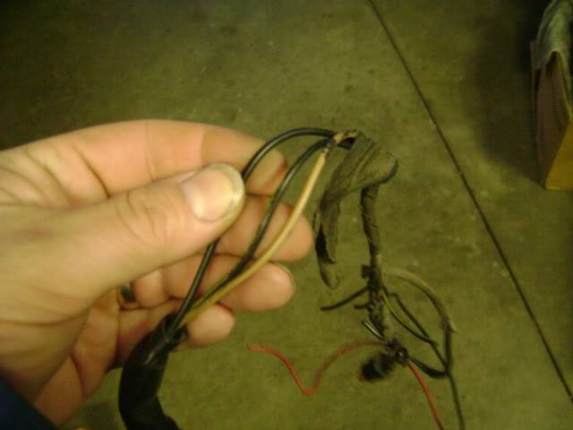

You can see the corrosion that caused it to drawback to the rear and kept popping the fuses every time I hit the brakes.

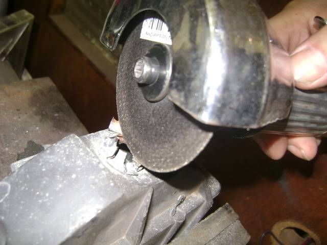

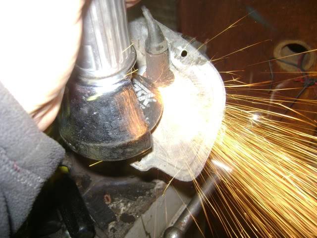

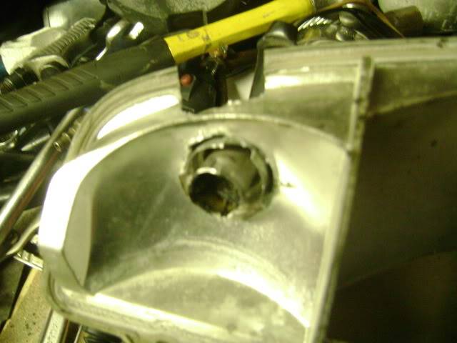

With a cutting wheel,I chop off the socket from the housing..

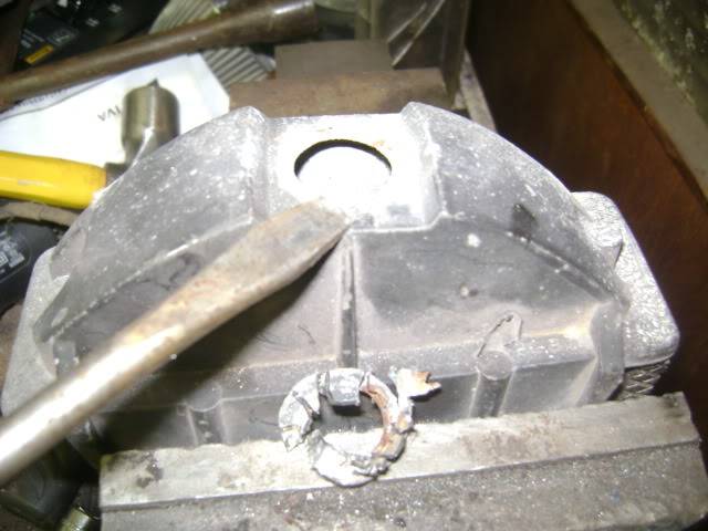

With a cutting wheel make slots in the remains of the stamped steel socket.
A dremel with a cutting wheel also works.
Carefull NOT to cut into the housing!!!

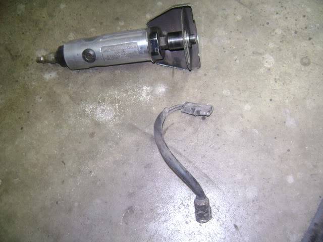

Then remove what's left of the socket from the housing..

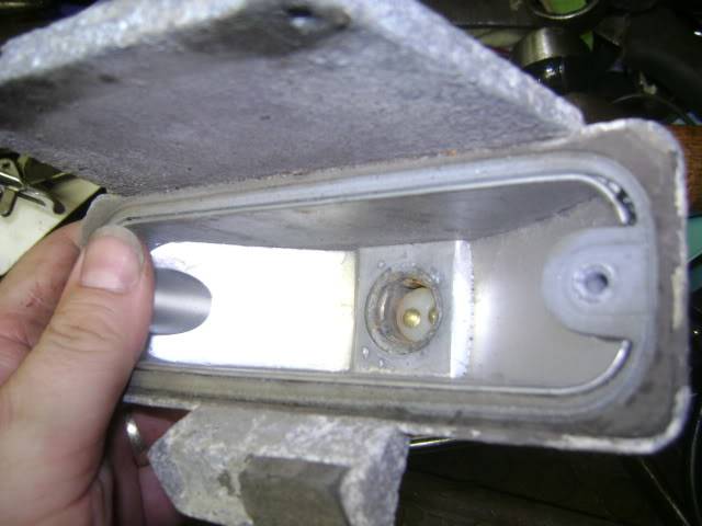

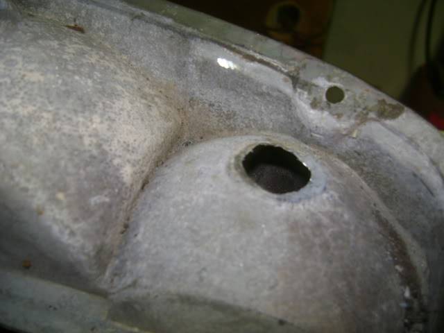

Here you can see corrosion had set in between the two different type of metals which causes a bad ground for the bulb.
This housing has actually rotted away behind the socket and the bulb never worked right..

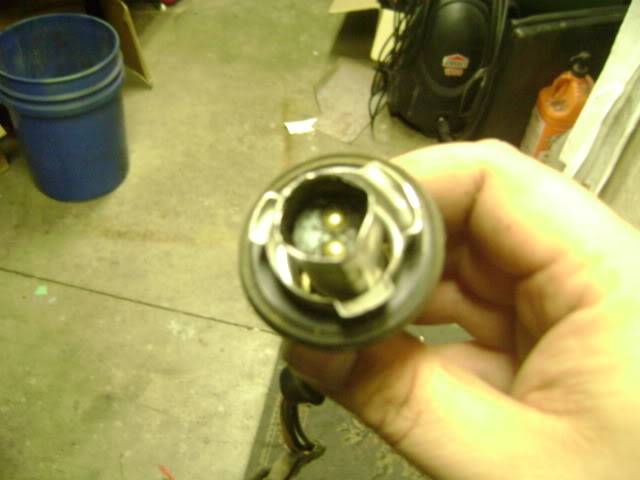

Here is a twist-lok style socket that I will be using in this demonstration.
You can either grab a metal or plastic type socket for your favourite scrap yard or buy a new one dirt cheap at any parts jobber.
Make sure you get one that has an extra wire for ground--which will be an important detail in this mod.

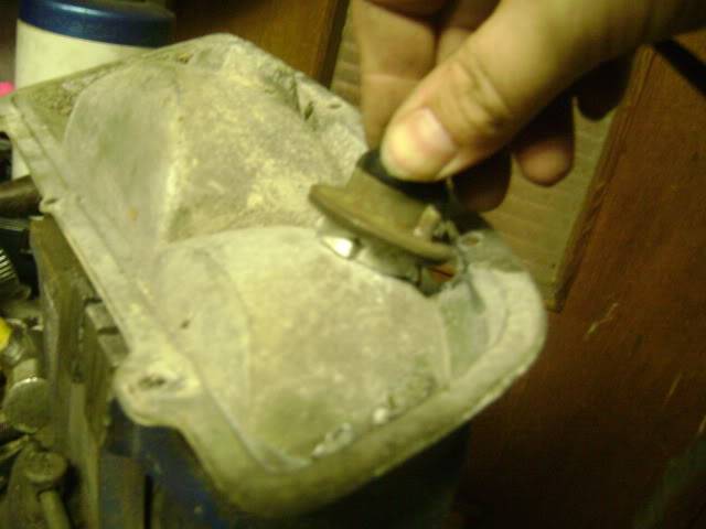

The plan is to modify the original housing to accept the twist-lok socket.

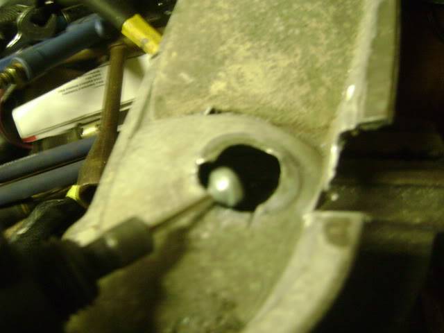

Scribe the housing where the notches need to be made into the housing.

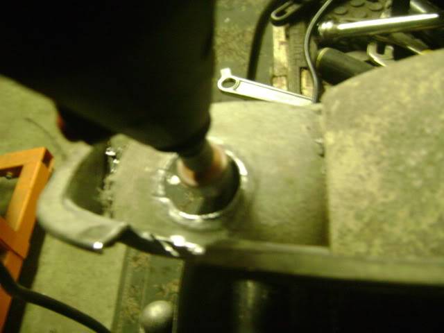

Using a dremel,notch the housing and the opening may have to be made bigger to fit the twist-lok socket...
Make sure to test fit often and grind a little bit at a time.
Too big and your priceless housing will be junk.
When done,the socket should fit snug into the housing for a water tight seal.
In some applications,the bulb may not fit through the hole and have to be installed with the lense off the housing.

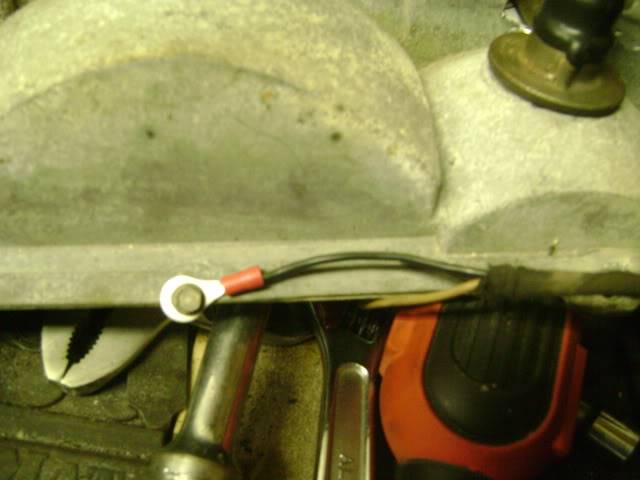

For the ground,use the third wire and attach it anywhere to the body close to the housing.
This eliminates using the housing as a ground and no more headaches.
