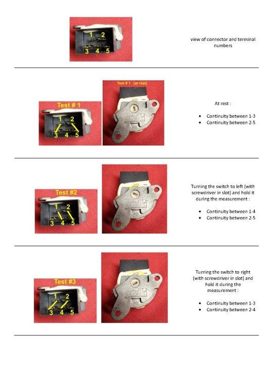

Last week I'm working on the tailgate, electrical side. I fixed the window/lock key switch, it only worked one way (down). The first, bought NOS on Ebay, did not work at all ! No contact at rest, neither to the right nor to the left. Probably oxidized inside. It's not removable so I lost $80 (it's expensive for overseas with shipping and taxes). I ordered another one asking the seller to check if the connections were OK, rest, left, right. He checked, being sure of himself, and indeed switch is OK. Now I can lower or raise the window. When I turn the key to the right (clockwise), I unlock then I lower the window, the opposite to the left.
If you have a switch problem I recommend having the seller check it, just because it's NOS doesn't mean it works! Here is the logic of operation, all you need is a multimeter.
