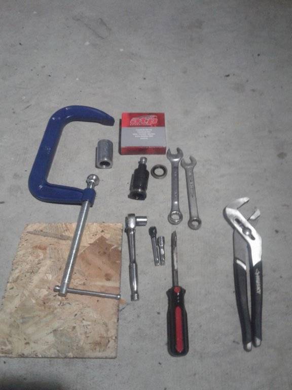

    Well, I did the two seal replacement today,Not too bad. I used the Methods and tools as stated in the thread starter. I used a bungee cord to hold the flat piece of wood on the pan for the C clamp ! Thanks MBar for this thread and glad his leaked is fixed and mine too,hopefully. Now I just have to remove the old seal from the tool !LOL

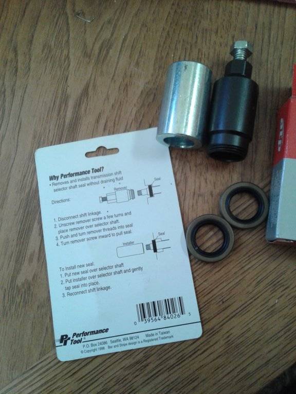

    Ha Ha, I put the seal in a vise and unscrewed it. I have had this tool for 10 years and finally got to use it !

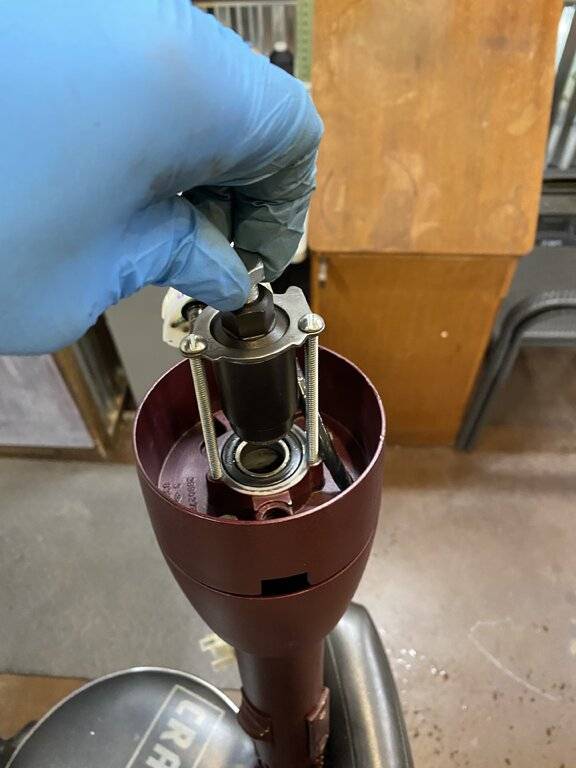

    The seal puller also works with long screws and the turn signal hold down, to press out the steering shaft.... Multi- Use tools. Adding the picture.

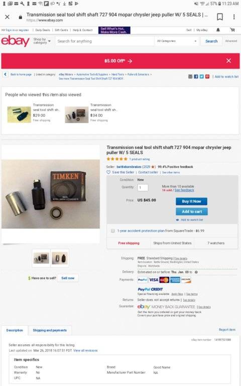

    The shop I mentioned seams to be offline. No payment is possible, no impressum, no replies. Weird. Why are these kits sold out everywhere? Any ideas where to get one? Maybe somebody of you guys wants to get rid of one?
  13. Big_John
    Big_John Illegitimi non carborundum FCBO Gold Member
    Messages:
    13,933
    Likes Received:
    8697
    Joined:
    May 21, 2013
    Location:
    Marcellus, NY
    The Performance Tool number is W84026, but I can't find one online anywhere. I did find another, more expensive version of this tool: https://smile.amazon.com/SST-1031-C...d27cd&pd_rd_wg=sKOGT&pd_rd_i=B011SBJSHA&psc=1

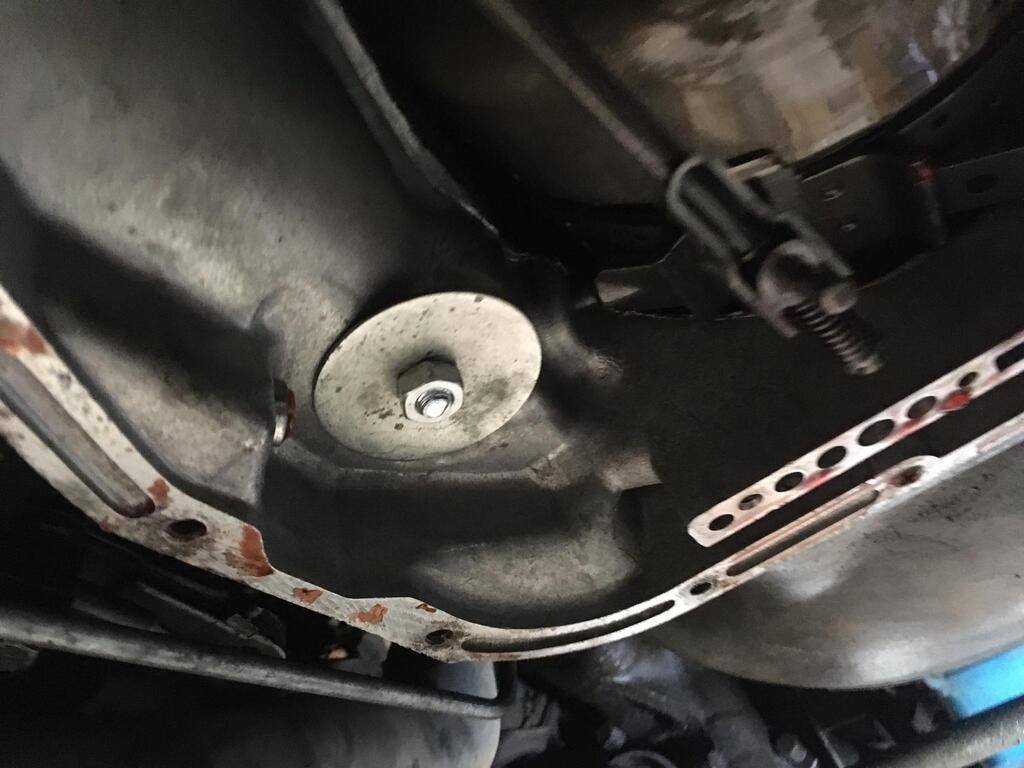

    Of course, IMHO, when the tool starts getting this expensive, the savings of dropping the pan to change the seal becomes moot. It's a lot easier to do this with the valve body out and really isn't it time to change the fluid and filter anyway?
    Once the valve body is out (IIRC 10 bolts) you knock the seal out and then pull a new one in with a bolt and a couple fender washers.
