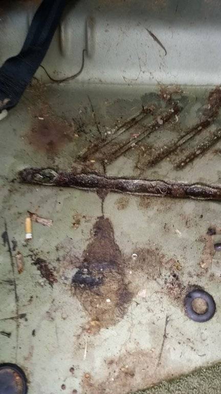

(1972 Newport) Today I drove somewhere and it started to sprinkle. By the time I was driving back, it was raining a normal amount. When I got back home, I noticed a dark spot on my rear seat. Sure enough I touched it and it was soaked. I of course I took out the rear seat, wiped and cleaned up all of the water, and vacuumed the seats. First time I have driven the car in the rain since September. For those of you that don't know the car, it has the factory undercoating in great condition, and is 99.99% rust free. The water appears to originate passenger side in the abyss at the front of the trunk. Any tips?

Just went and looked at it. It appears ok, and is still all very pliable. There is a dirt line where it seals to the trunk too, so it appears like it seals. No water in that part of the trunk either, I pulled up the mat. I also checked the passenger door seal. It was also good and pliable. The water came from behind and underneath the seat. It was wet right about where your keister would be on the seat. It was wet the most on the floor right under the seat. You know those plastic plugs in the floor? I thought it may have been one of those, but how could that spray water up the back of the seat?

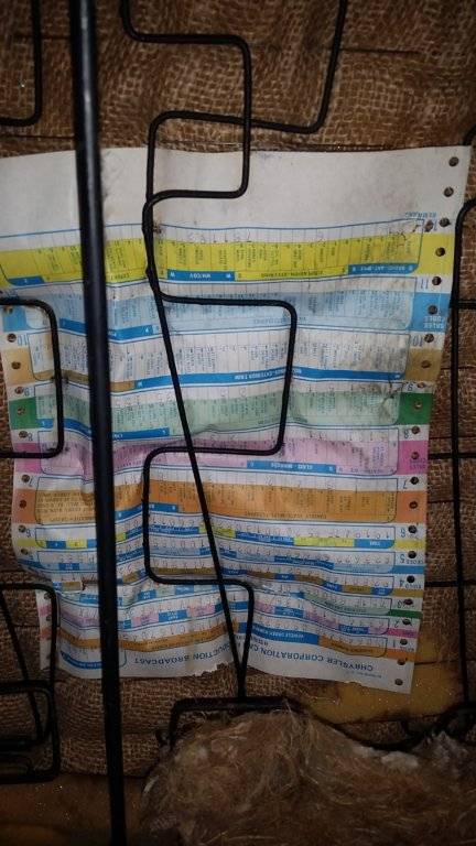

Good news though, I found build sheet #3 for this car! :thumbsup: Also some kind of tag too. Still can't find the water though.

My temporary fix is still holding back the water. Also a tip for you go-doers:
While I had the rear seat out, I had some sound-deadening material in the garage so I put a layer between the trunk and the factory panel that was already behind the seat. And wow it made a big difference in road noise.
There's still a puff left in that cigarette butt from the 70s.
