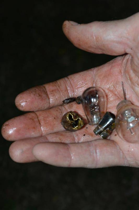

Aside from a recent wrestling match with the front directional light bulbs (which I lost), my previous visit involved trying to get some of the interior and dash lights working again. At some point it had 4 way flashers added to it which only function on one side and need to be sorted out as well.

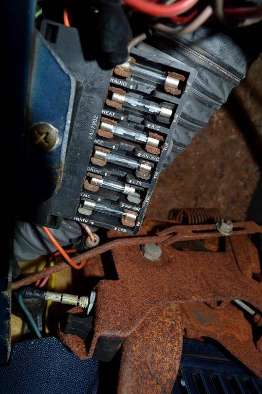

Sure enough, my worst fears were realized when I crawled under the dash to inspect the wiring and fuse block. See attached photo. I have some cleaning to do. Might just replace the fuse block, we'll see.

Yup Ive seen that fuse block before...same look my American 66 has. Cleaned it up replaced fuses and voila dash lights then 30 seconds later radio started smoking...sigh. As you said Mopar Gods giveth...Now I am on the hunt for a replacement radio that isnt $500 and is a non smoker. Read a few posts here about rebuilders so that might be the way to go. Dont give up on her tho I look at it as we are curators of a mobile museum that needs to be seen by the plastic driving public reminding them that real steel is not a movie starring Hugh Jackman!

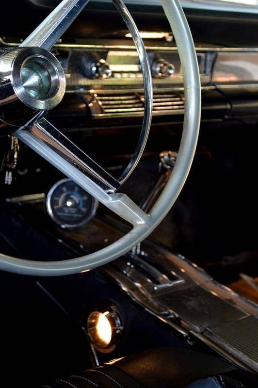

One of the big disappointments when the car arrived was how few things actually worked compared to the seller's description. No console lights, no dash lights, no map light, no trunk light, etc etc. After picking up a bunch of bulbs last month I dug into the interior lighting first. Moisture inside the car and trunk from leaks had created its own issues like stuck bulb bases. Broke the first console bulb trying to remove it, and spent half an hour figuring out how to get the map light bulb out.
I had been concerned that bad connections in some remote place under the dashboard would be the cause of all problems including the console. So imagine my surprise when the first new 1004 bulb lit up nice 'n bright. Replaced both in the side courtesy lights as well as the one in the map light. Voila - light galore! Also disassembled the vacuum gauge to find the #57 bulb in there is toast, but had no spare. Got some on order. The console shift lighting is out also, but I'm guessing(hoping) it's just burned out as well.

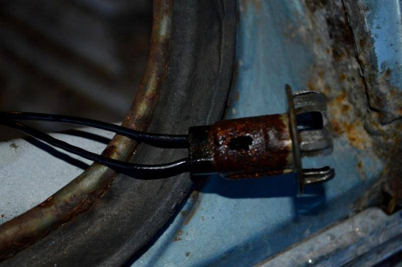

From there I moved to the trunk where things got a bit more nasty. The trunk light was still in place but pretty rusty. Spent over a half hour breaking tearing and yanking out the base. Flushed it well with WD-40 to get the crud out and help the contacts move more freely. The new bulb didn't fit well but, lo and behold, it actually worked. Next was a tail light bulb not lighting. Another bad bulb, another fight to the death trying to remove it. This time the socket ended up being toast, so I'll need to track down a replacement before continuing. Looks like it had been changed before.
Also tried to install the front directional bulbs in the bumper again. No luck, but did get one in far enough that it made contact and lit when the parking lights were on. Sockets are cleaned out and the springs seem to work fine, just need to get my wife out there with her smaller mitts to give it a try.

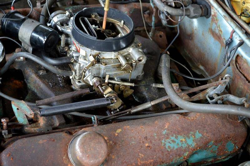

On the meatier side of things, the kickdown linkage had been disconnected at some point, perhaps due to the carb swap or who knows? Spent some time trying to decipher it using the manual. Decided I would post some photos and ask other owners before diving in too far. I did hook it back onto one of the pins but noticed when I revved the engine, the car tried to move backward a bit in park. So.....something for another day.

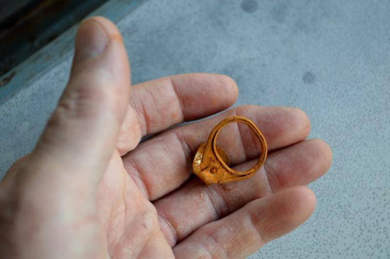

Also found a neat little piece of history while cleaning out the quarter panels. A true blast from the past.

I'd pick up some Evapo-Rust for those nasty light sockets. The one in the trunk that you lubed up with WD you would need to flush with some electrical clear before soaking. The stuff does a pretty good job and isn't toxic, a plus. You can buy it at Advanced Auto.

Thanks John. I used SeaFoam Deep Creep on that one, it was so bad. Problem now is that there's so little metal left on the socket and rust is so bad, I can't get a bulb back into it so it needs replacing.

Well, oddly enough, I went out for something else the next day, opened the door, and the interior lit up like an arcade. The passenger side switch is working mechanically but not electrically, will need to chase that down. Apparently the driver's side switch is sticking a bit because it did the same thing today (no lights), then came on a couple seconds later. Thought I had sprayed the switch with cleaner a while back, must've forgotten.
Replaced blown bulbs in the vacuum gauge and console shifter today. Turned on the lights, no joy. Diagram in the book shows a fuse in the circuit, that'll be the next culprit.

Went back out and no lights again. Jiggled the firewall connectors and on they came. Just cleaned and adjusted all of those contacts a couple months back, looks like something is still flaky.

Temps back up into the 60s this weekend but also more rain. The plan is to get the new tail light socket soldered in and also rework the linkage on the carb, maybe even get the electric choke working.
