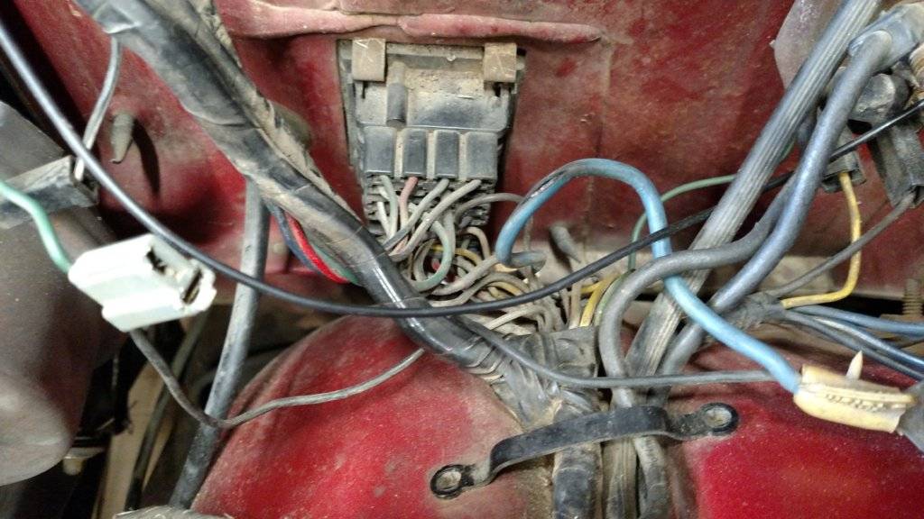

Those rusty clips hold the inside housing to the firewall. There are three removable connectors on the engine side of the firewall that all run horizontally across the housing. Squeeze the clips on the ends of the top one and wiggle it off so you can see the clips on the next one down, etc. The clips I'm mentioning are part and parcel of the black plastic connector itself.As some of you may know (from my postings in another thread regarding battery charging issues), I have had a problem trying to diagnose the cause of my no-charge problem. I have attempted to perform a couple of tests @Big_John and others have suggested. And being the spaz that I can be, I inadvertently allowed the hot batt lead at the alternator to go to ground. This caused a lot of smoke to occur in the firewall area where the starter relay and and voltage regulator are located. Looking at the photo below, I assume I have fried the fuse-able link (big blue wire) that runs from the starter relay to the bulkhead connector.
My questions: What is the best way to accomplish a repair of the fuse-able link? I assume I'll hafta disconnect the bulkhead connector and somehow disconnect the blue wire from it. I just can't figure out how to get the bulkhead connector to disconnect. There are four rusty metal clips (one at each corner of the connector), but pressing them or poking them, etc. has no effect. Is there a trick to this? Also, there is a black wire that I should also disconnect and replace that runs from from the fuse-able link to a connector that plugs into the voltage regulator, and again, I can't figure out how to get it loose from the plastic connector. Is there a special tool I should use for these connectors? Here is a photo of the whole mess:
Does this help? Fusible Link
