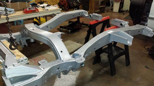

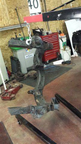

The sub frame project has begun..
Now i think we can call this old stub frame a true stubby frame! :D

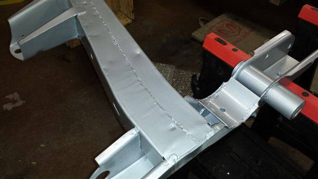

Quick update.
I have been challenged on removing the rear connector pieces from the side rails.
Spot welded & bolted. - guess they didn't want these things falling off :D
Busy cleaning up rusty flakes from the underside and testing the firewall for ease of cleaning up.
I think no matter what it is going to be a bit of a haul getting this looking good.:snow plow:
I have been using the3M rust wheels which last only about 5 minutes a piece which is a bit disappointing since they cost $10 each at the local retail outlet.
It's still way better than sanding by hand!
Here's a few pic's of the latest progress.
I sandblasted the Stub frame last night and tonight have applied the first coat of Rust Bullet.
I used a brush & small roller & I must say it laid out very well. almost looks like it was sprayed on.
Good thing I have a proper air mask as the fumes reminded me of my earlier model airplane days using the nitrate dope.
I'm seeing details in that stub that I never would have noticed otherwise.
You appreciate its massiveness.

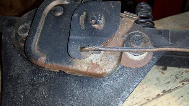

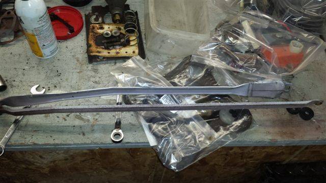

Just cleaning and getting ready to bead blast more parts..
Discovered today that I have a leaking LF wheel cylinder..
Takings lots of reference shots for the re-assembly process

attachment.php
Scary what people consider a repair. Was this sitting in a field because the rest of the car looks good?
