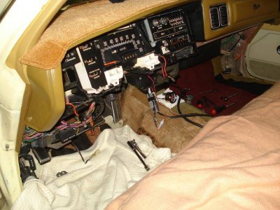

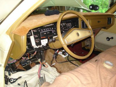

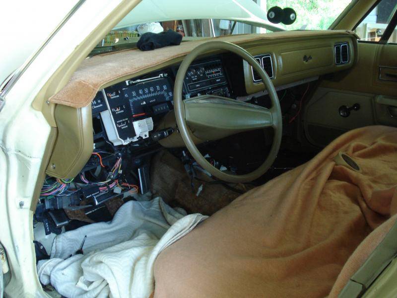

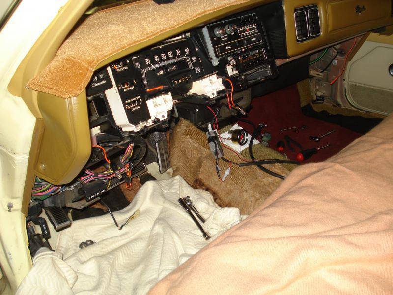

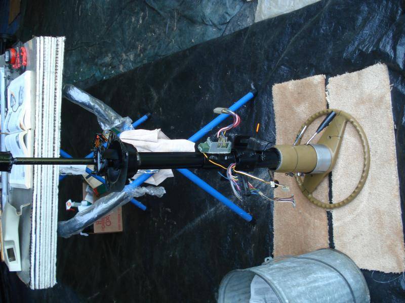

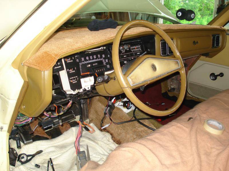

Finally got the column in. It wasn't too bad, except I didn't realize I had to take the entire lower dash out to do the job. That was a pain because then you have to remove the "floor air" duct, which is where I mounted my oil pressure gauge. The wheel has some bad cracks, Ill put a wrap on it for now and repair the wheel over the winter. I like the leather wrapped ones I have seen on this forum and on other NYB's.
The horn also does not work, ran out of time to diagnose it. One part I do need is part # 3467 432, its the plastic retainer under the steering wheel, DSC01485.jpgDSC01486.jpgDSC01487.jpgDSC01488.jpg that is over the steering shaft and keeps the horn coil spring on the contacts and insulated from the shaft. When I pulled the wheel to change the ignition switch this piece just disintegrated. I tried super glue (very wishful thinking) but the part just exploded when I put it back in. Any one got a source for one????
