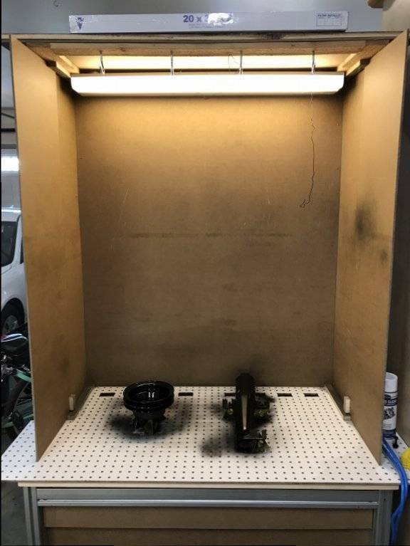

After too many years of overspray and paint fumes, I finally built a small parts downdraft paint booth that will double as a sanding table for wood working.

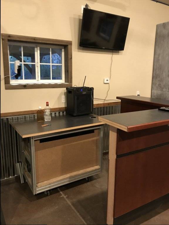

I started with an extruded aluminum frame structure on rollers that I also use for my upholstery sewing machine.

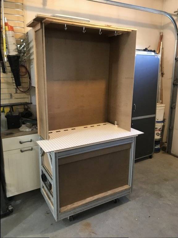

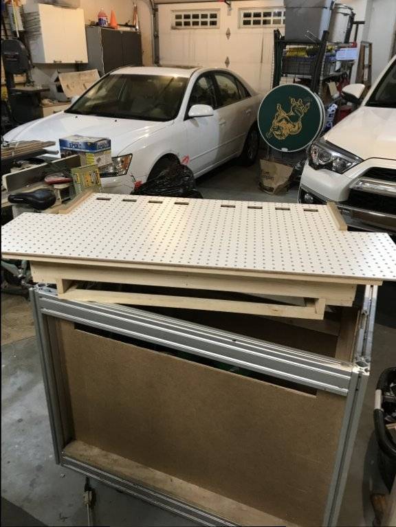

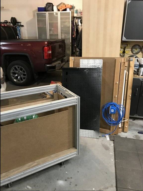

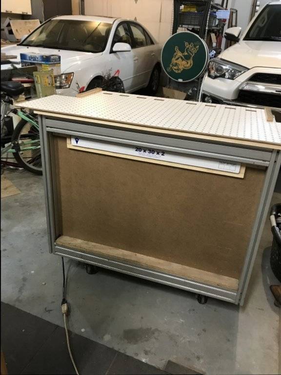

I built a box with peg board on top and furnace filter below. Due to the channels in the side of the aluminum I was able to slide hardboard sides in to enclose the cabinet. I also got a 4" ventilation fan with a charcoal filter to get rid of some fumes. If I am sanding I can hook my dust collector to another port so I don't have to suck the dust through the charcoal filter. In retrospect I could have just used my dust collector hooked to the charcoal filter as the suction. But I do like the variable speed control of the exhaust fan.
