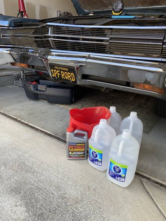

This thread has got me thinking a lot about my temp issues on my ‘68 300 (440 engine). I will likely do a flush because the coolant has been in their a while.

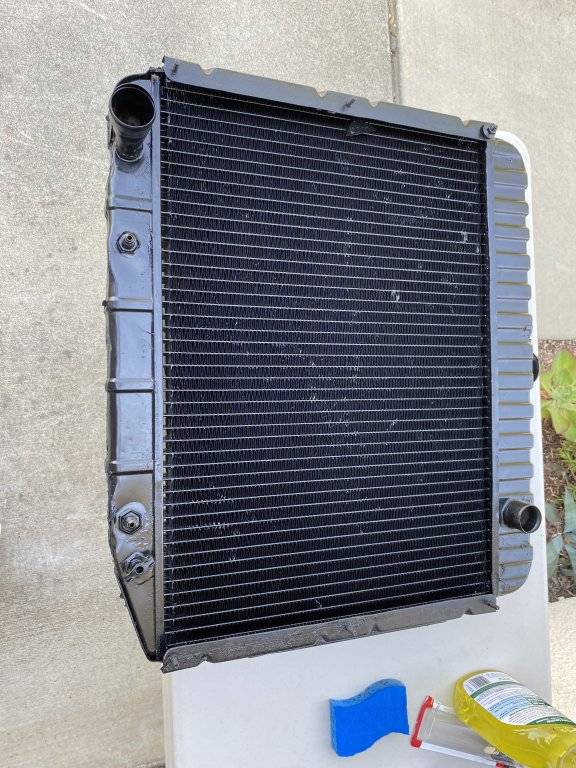

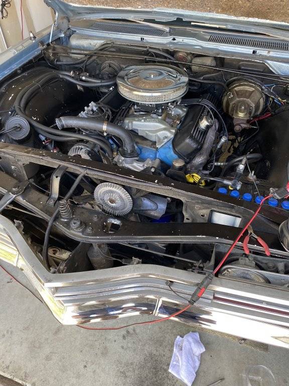

Here we go!
Before:
After coming in a bit.

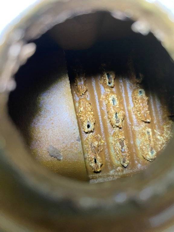

Thank goodness for a big attic!

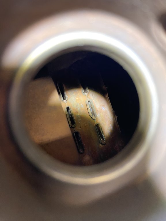

The inside looks much better on that one:
I’ll have this one pressure tested tomorrow.

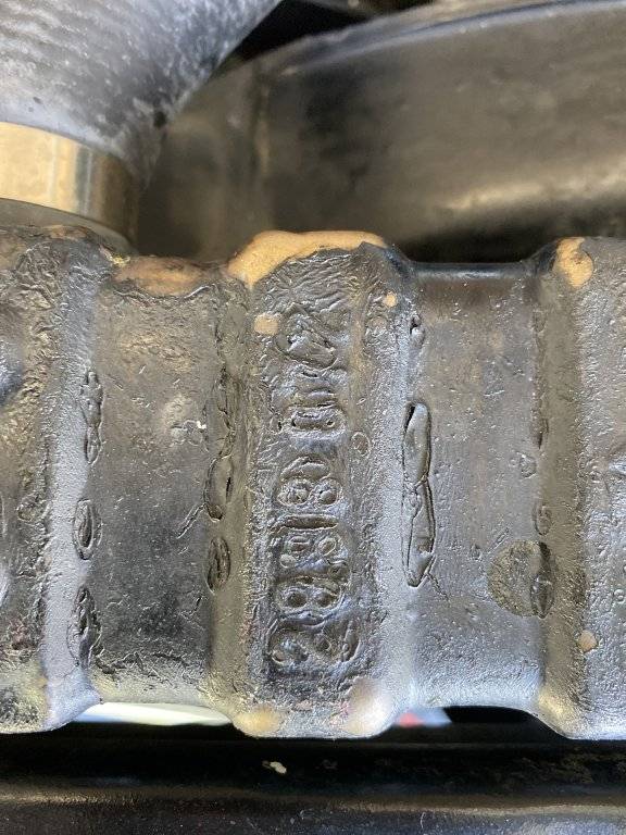

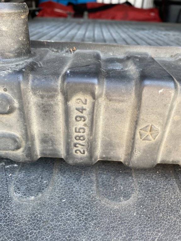

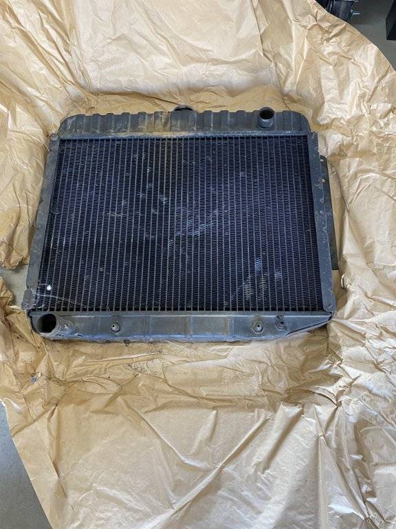

Is a radiator labeled 2785-942 (my spare) interchange with a 289(?)8-072 (the one installed)?
Spare:
Installed:
Thanks for that advice.
I did some research at myMopar.com in the parts books. It appears the 2785-942 is a 1967 rad for a 383. The 440 in ‘67 has a different part number. By 1968 it appears the radiator for the 383 and 440 are the same part number. The measurements do match up and I deleted my AC some time ago so I am going to use the spare one (my car is nowhere near parts matching).

My spare radiator checked out well. Picking it up today and probably have it in by this weekend for some cars n coffees.
Probably gonna get the old one reconditioned as well. Clearly having a spare in the attic worked out well for me. :-D

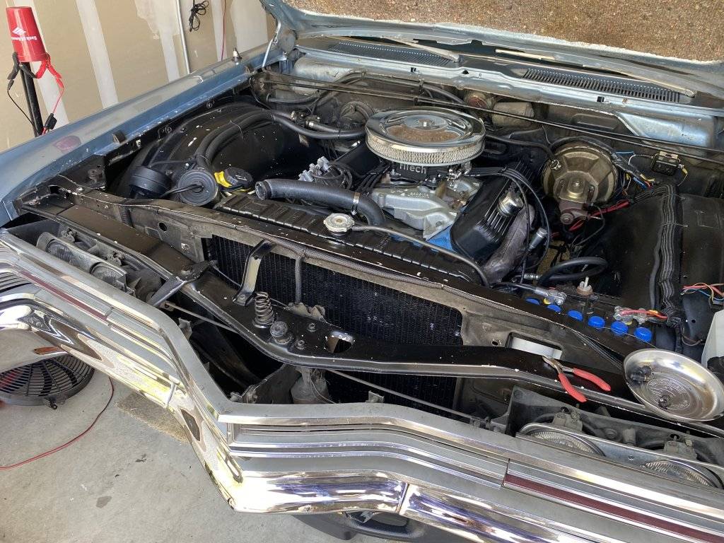

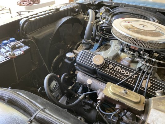

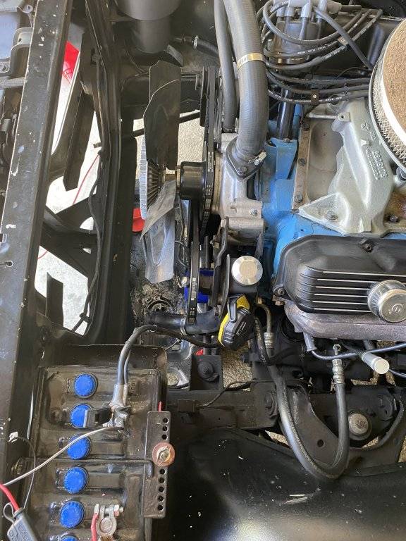

Out with the old…. In with the new! I am surprised at how easy of a project this has been so far.
Since it is all apart, I figured I’d install new hoses too. They will be here tomorrow.
The old:
And the new:
Took a 6 hour drive to Watkins Glen NY. It ran fine but it still was in the higher end of the gauge. It didn't go over so that was a plus. The cooling system has been gone through. Rad professionally flushed, shroud installed, larger fan and new thermostat. It's a 318 2 barrel. Maybe I need a larger radiator?
