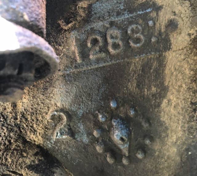

my imprint has an "M" preceding the 318- that would be 1983 by the system you mentioned. Could it be that the 1283 on the block is in fact the date- a Dec. 1983 block??
Yes, but most will also show a day of the month.
wow, I find that incredible. I bought that motor from a junk yard and I thought the guy told me it was from a wrecked '73. It's been so long I can't remember for sure. Maybe he told me it was from an '83.
I do remember something with the intake manifold not working with my '68 linkage and carb and I think I swapped the intake over.
The crazy thing is that my timing cover appears to be from the '68-'69 group and I know I never swapped the cover. Too, my new water pump will fit my existing cover and it was specifically for a '68 318.
I wonder if the bone yard guys did some reassembling of the motor before they sold it? the 1283 for Dec. 1983 jibes with your alphabetic system for the front imprint...

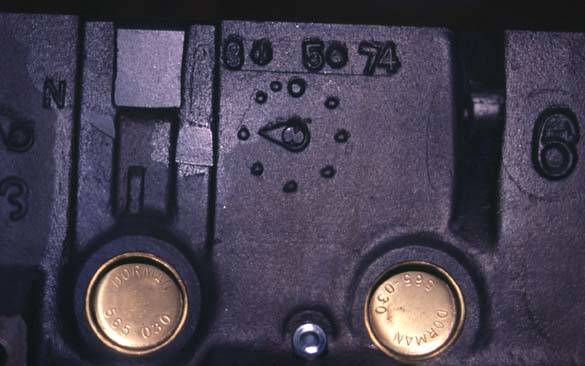

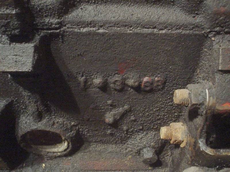

Had a 68 318 and it had the same date code location as the 72 340 in post 50. Every 60's block I've ever seen had a casting date on the side but granted that's a small percentage of the 30 million or so they made so probably some slipped through. The info on the driver side front can be very lightly stamped & hard to see, especially with paint & other crud. Here's another pic of a 68 318 I found. Please don't believe everything you see on youtube videos:lol:
well, there you go. A '68 with a date stamp. So much for the youtube guy.
I believe you thought the 1283 on my block was just a casting number. Maybe it is indeed a '68 without a stamp.
As I clean the block the mopar blue color is starting to show through. Wonder if the '68 blocks had blue?

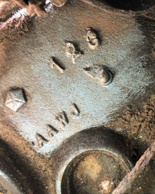

I feel pretty good about the stamp on the driver side front (if you're referring to the one behind the power steering pump) especially since it was on a smooth, surfaced area:
"M318R 06 131947"
What it means I don't know.
Dave Lux mentioned the alphabetic system starting in '65. If that is correct that would make mine an '83. That would jibe with the 1283 on the sides of the block but the date casting in your image is way different with a dot between the numbers.
Maybe mine is one of the 30 million that didn't get a date?
There doesn't appear to be any other numbers on the block (either side).

yea I don't think the 1283 is a date stamp based on what you've been able to pull up here. Too, my intake is red- which I couldn't remember for sure whether or not I swapped out of my original '68 but now am convinced I did.
Too, the '73 quote was just what I can remember but it's been a long time. He could've said anything.
So we know the block is blue- I'm not sure which blue (turquoise or mopar blue) but the timing cover that came with that engine is from the '68-'69 series.
A '69? I'm just interested now. I know it doesn't really matter but I'd be nice to know.
