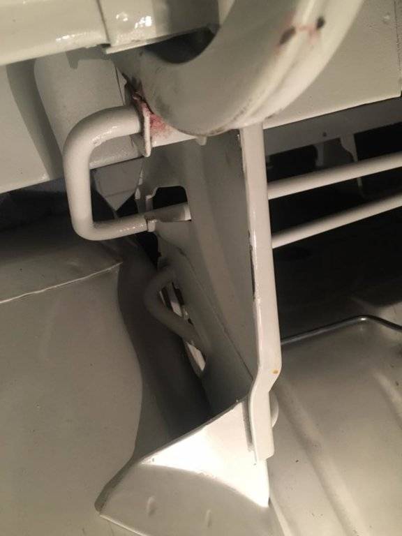

I have found plastic ones but they will wear out very quickly. Anybody got some original steel ones.ThanksCan anybody help me out with sliders for the ends of my torsion bars in the boot of a 65 fury convertible. I am told they are different than the sedan. Thanks
thanksI'll check my parts car in about 4 hours.
I don’t think these were ever steel.I have found plastic ones but they will wear out very quickly. Anybody got some original steel ones.Thanks
Sliders for the hood were steel on some Formals.I don’t think these were ever steel.
Didn't know that... Probably for the heavy hood. I would expect the '66 Fury to have a plastic slider just like in the OP's pic.Sliders for the hood were steel on some Formals.
This is not making sense. From the pic above,, I put some hard plastic in there but the steel hinge was grinding it to death
That's a plastic slider. No doubt in my mind. As Stan says, they do need grease.As in the photo above the owner has told me his are steel, I put some hard plastic in there but the steel hinge was grinding it to death. Has anybody got some advice in aligning the trunk as I am having a bad time trying to get it right, do they use shims at all
This ^^^This is not making sense. From the pic above,
I see nothing wrong with your plastic sliders. They are aligned properly.
But they need grease on them.
Strange, the ones I was looking at today were round, and had a lip on either side of the hinge. I'll take some pictures in the morning.They are square
