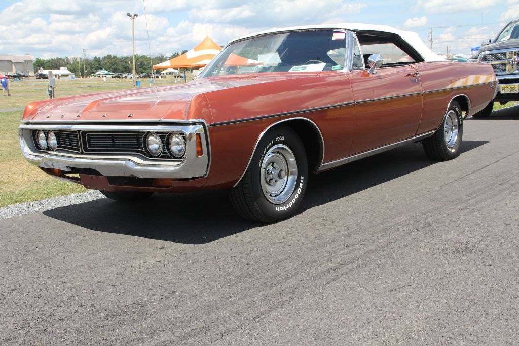

This is the Lucky recipient of the new front end stuff. Since she has the most miles on her by over 45000 compared to the other two and is driven a lot more, she is first on the list. View attachment 123231
I'm not against you upgrading your bars but knowing how much you like to take the roof and put it's wight into the trunk and the flexibility of a conv chassis I would not jump much. I do agree that TBs probably do "wear/sag" new ones will have to "settle" I would think so you probably need to keep a eye on the ride height for a while.
