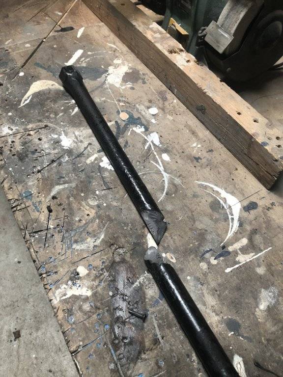

Can somebody help me to get torsionbars for mine 74 imperial , mine broke!
Am I seeing your bar correctly? It looks out of round. I can also see a stress point where the crack started. It should not be too hard to find a pair of bars. Where are you located?
It’s round… bars are 47inch long 1.06 thick and the head is 41mm(+-1,6inch
Located in the Netherlands

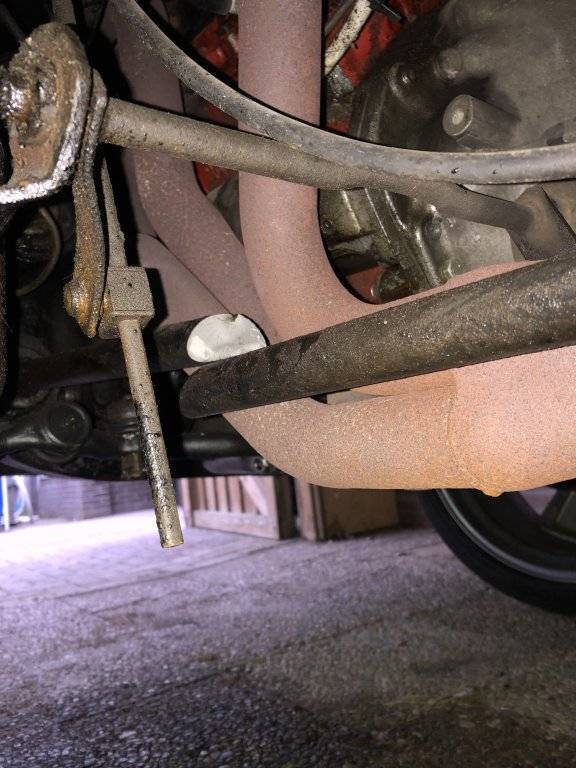

Just a guess, I would think having them cranked up to clear your wheel\tire combo isn't good for the bar. My FSM says to measure 10 1/4 inches ( I think ) from the ground to the bottom control arm pivot at the frame. It seems to me if it's higher than that, you've got too much tension constantly on the bar, and its fifty years old.
