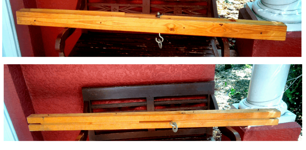

Oh yea, one more thing. Does the engine need support or are the mounts going to hold it? In my younger days I'd have just yanked it and let the chip fall where they may so to speak. But I'm tiring of doing more work "just 'cause".. Besides being broke and all.
Brace across the fenders?
Like so?
1000 lb. Capacity Engine Support Bar
Exactly. Except I made mine out of 2x4's...
Your mileage length may vary...
Yeah I'll prolly visit the Home Despot but I'll most likely be using square steel tubing.
