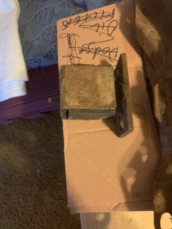

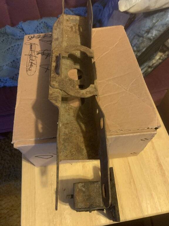

1970. That's what I'm thinking. The flange should be on a certain side. FSM doesn't talk about it.
I didn't look, or make note before giving it to him. Just bought all 3 mounts and said change them.

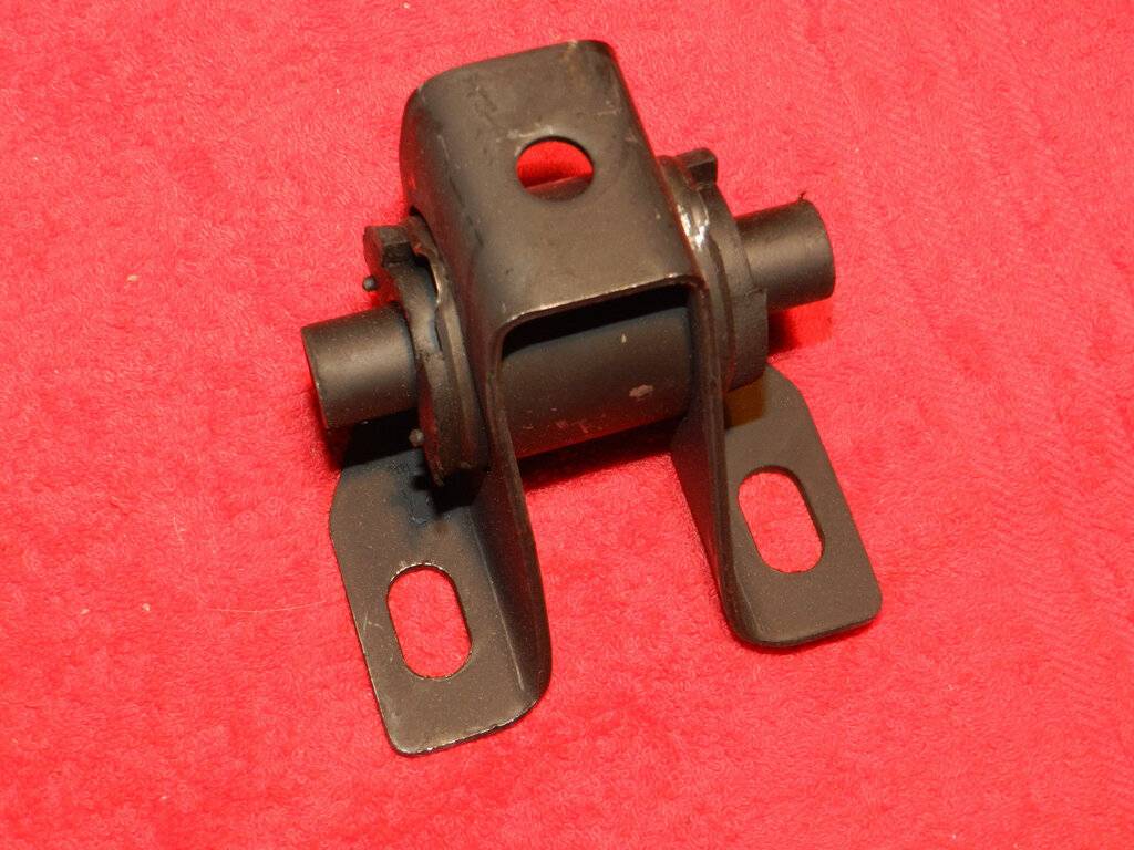

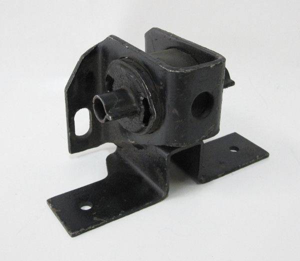

That’s the wrong mount. Kim
It replaces the guts on a stock mount.

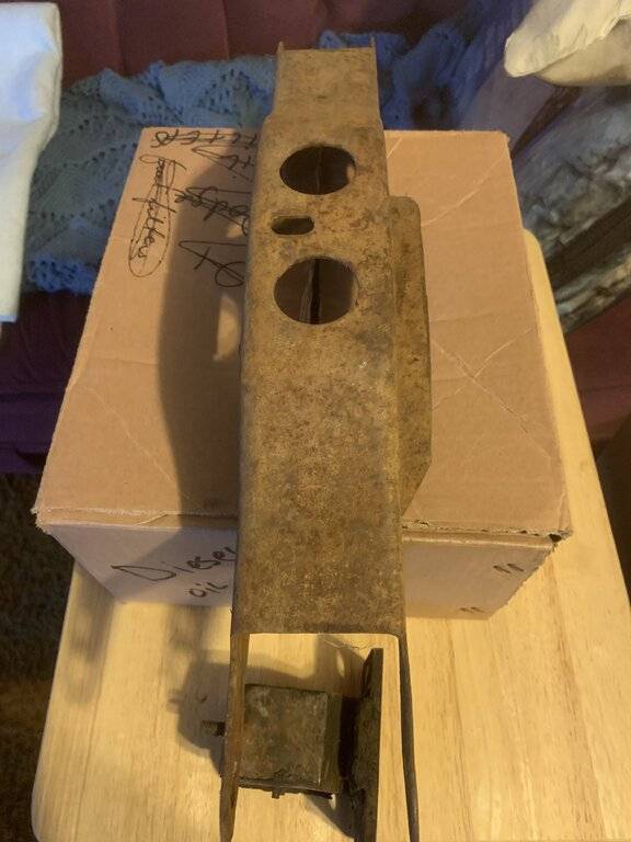

Mine looks nothing like these pics-

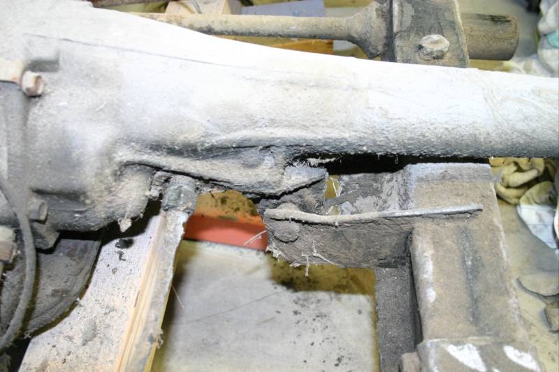

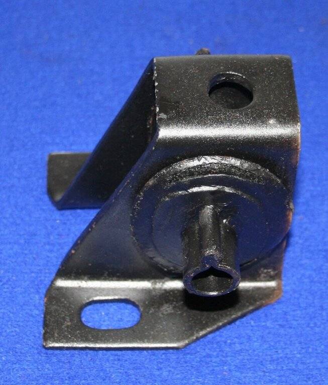

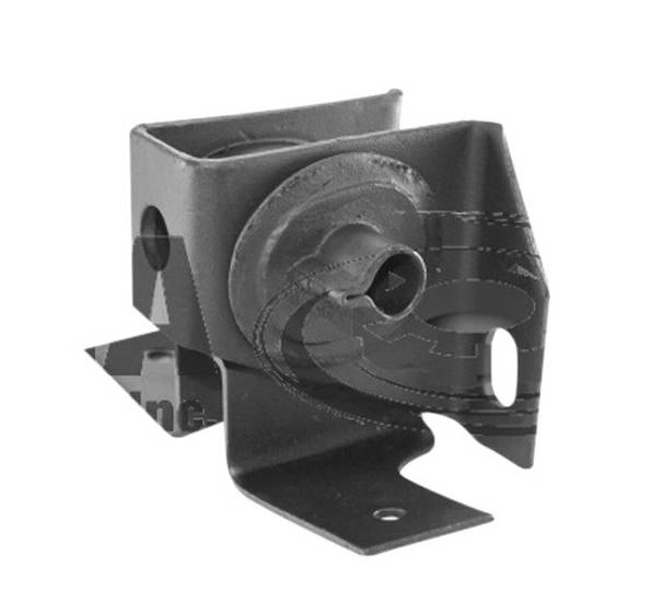

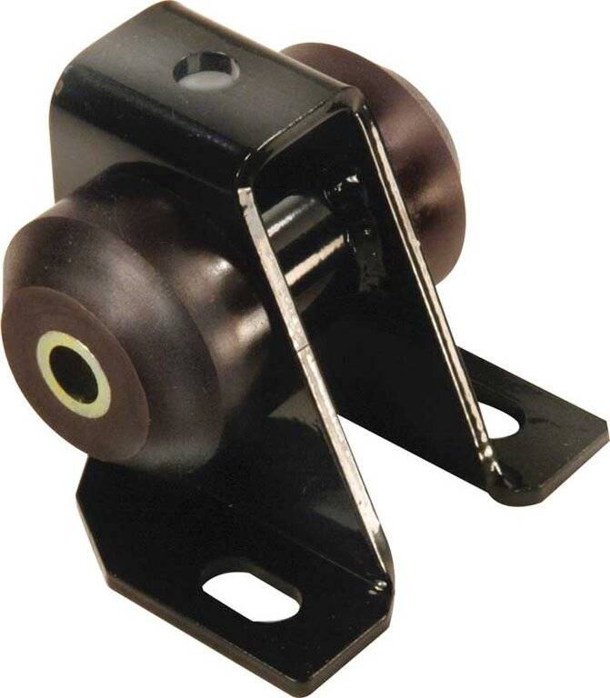

Well then since you haven't included pictures of your problem (that's why pictures are important) how about one of these mounts?
And it seems that there are a variety of non-OEM aftermarket styles for the 1970 era cars.
