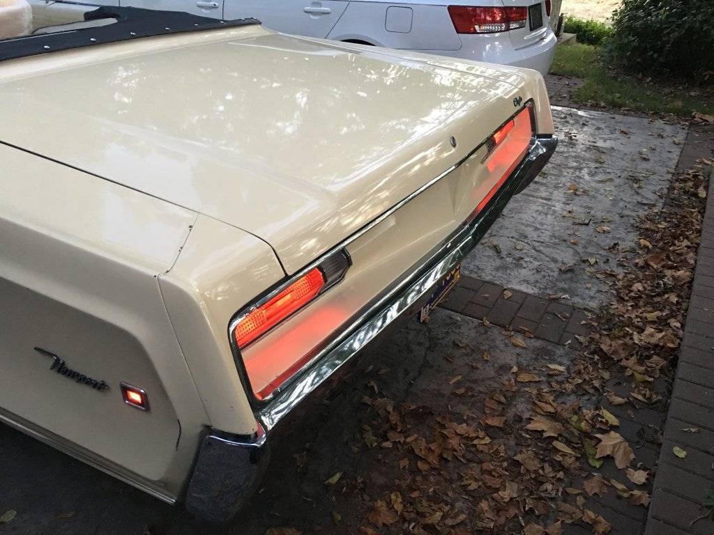

I got the 2 Amber Sylvania Zevo bulbs today and went and put them in the front. They fit but are taller than the stock Edison bulbs. I was thinking you could file off the top heat sink to match the height of the stock bulbs without much trouble. The high beam portion would only be on for the turn signals so I wouldn't think cooling would be a problem. Anyway I put in one side and they fit as I said and turned on the running lights to compare with the other side with the Edison bulb.
The Edison bulb was much brighter than the Zevo. I put on the flashers and the Edison was much brighter. When I did the rear [4 zevo led's] it was a marked improvement over Edison. What I think is happening is the Edison bulbs in front have a lot more juice than before because the rear bulbs are consuming so much less current. Long story short I left the Edison bulbs in on the front and the zevo's in the rear. The angle of the Zevo's when installed in the socket was such that the main beam of light was pointed up and down on the rectangular reflector which I wouldn't think is good.

Your results may vary! For me the rear [4 led lights] were brighter on braking and turn signals than Edison bulbs. Running lights were not any different. After installing the rear leds as I was happy with them I tried the 2 front Amber Leds. The way they were oriented with the leds's pointed the wrong way in the housing they seemed not as bright as the Edison's. The Edison's were now brighter than before because there was less draw from the rear by a considerable margin so I stayed with the Edison's in front. The rear led's helped the front incandescent bulbs.
I spent 40 bucks for the rear [4] led's and 15 for the front which I don't use but overall I feel it was an improvement back and front.
I think it sounds like yours are perfect... you got the desired improvement without needing to relamp the entire car.
