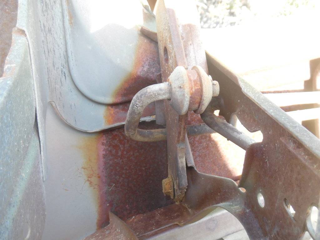

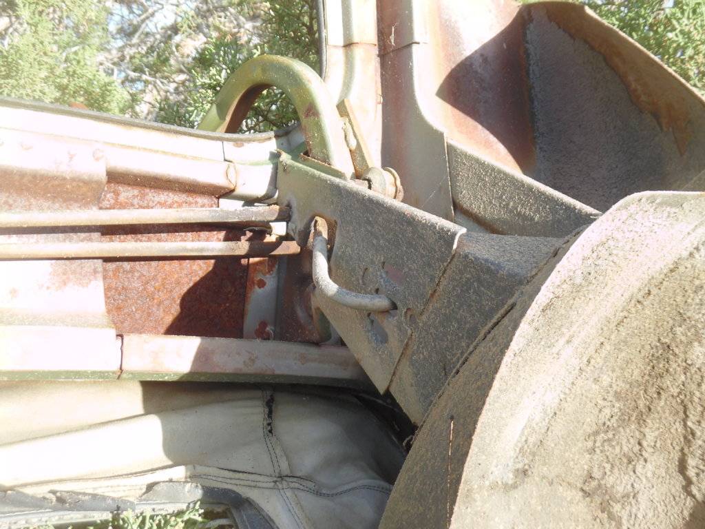

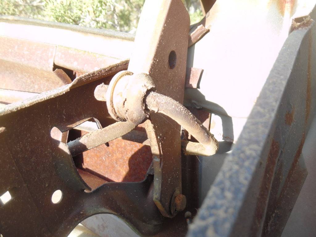

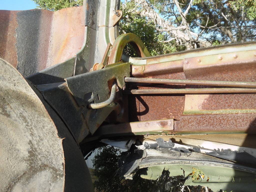

Can someone with a 67 Dodge Polara post picture(s) of how the torsion bar trunk lid supports work? My convertible was delivered with the bars lying in the trunk. Service manual is not much help.
Thanks
Will
These are from a '68 Polara convertible. The '67 should be similar.
