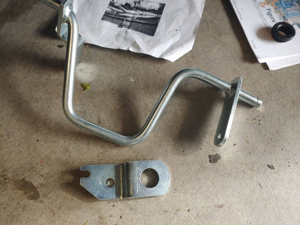

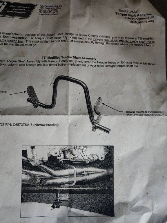

Sorry about the torque shaft assembly for my cbody 66 Plymouth Fury 3 and I can just not get this thing to work! The directions are Beyond poor. Has anybody else use this particular adapter before and if so do you have any pictures you can show me I mean I have tried Every Which Way but Loose
1
The bracket in the photo is the "narrow" one. That only works with the small tube header. If you ordered the larger diameter headers, you have been supplied the wrong linkage.

I tell you what if so someone's getting a ear full! Every time I call Mancini racing act like they got something better do and take your order and I specifically told him what your car I had. Yeah I got the long tube headers and you look like the one in the picture. Is there anyone else who might sell this part?

I've gone through tti directly, and got what I needed the first time. I was able to use the stock rod, fortunately, without any issue.
