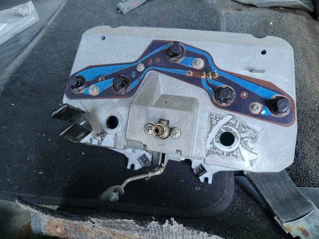

Hey everyone, just catching up on this threat while searching for information on the dash cluster bulb twist sockets for the #57 style bulb (anyone got 2 to spare?).
Anywho, I was trying to figure out why there were no turn signal bulbs going into the back of speedo on my '66 Fury VIP.
As you can see by the picture it had tape over the holes and this car has indicators on the hood.
Thanks for the above info. Now all I have to do is figure out where the hood wiring plugs into in the engine bay!
Hi Brad,
My 73 had fender top turn signals and no instrument cluster signal lights.
I also read about a 1967 that had the same situation.
I think your dealing with a factory choice to not have turn signals in the instrument cluster when they are on the hood or fender. Ben
