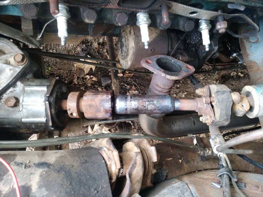

    Looks like it should work but being a safety sensitive part make sure.

    might have been cool to make an extension with a two bolt flange at each end so it'd be a bolt on. if you tig professionally, i'm sure you'll make it safe.

    Heres the end product. I thought about making an extension after I cut it lol. I'm just trying to make this thing drive right now. Next year I'm gonna tear it down and make a lot of things better. I work in a Fab shop. Been welding been welding since I was 16, but professionally since I was 20. This should do the job!

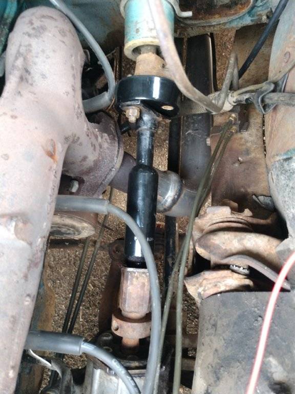

    Here it is temporarily installed. Fits good!!

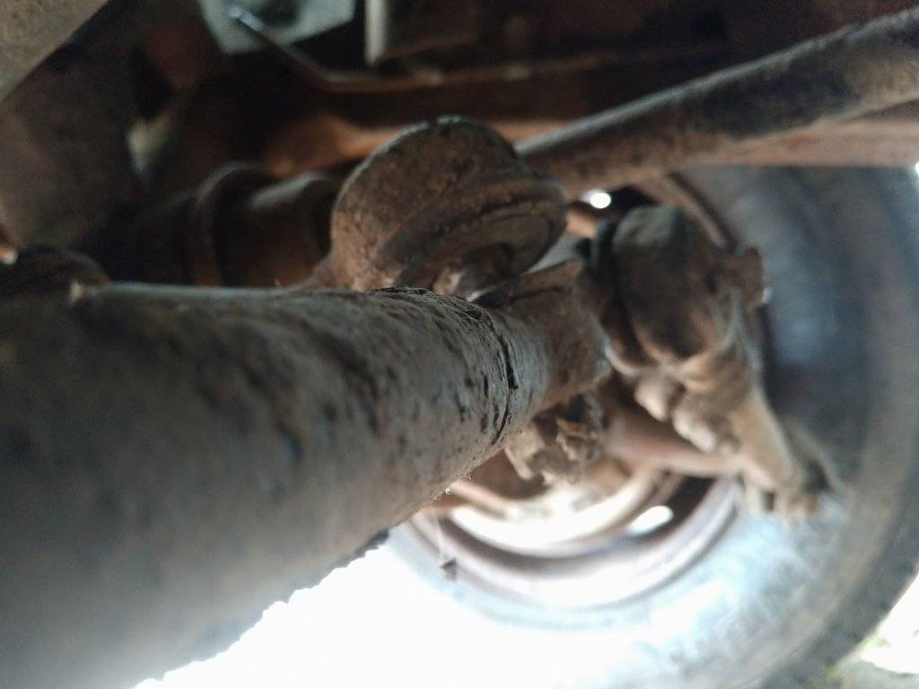

    When it rains, it pours. I was gonna reattach the pitman arm and noticed a ton of play in the idler arm. Looks like I'll be replacing that as well! IMG_20190513_165210833.jpg

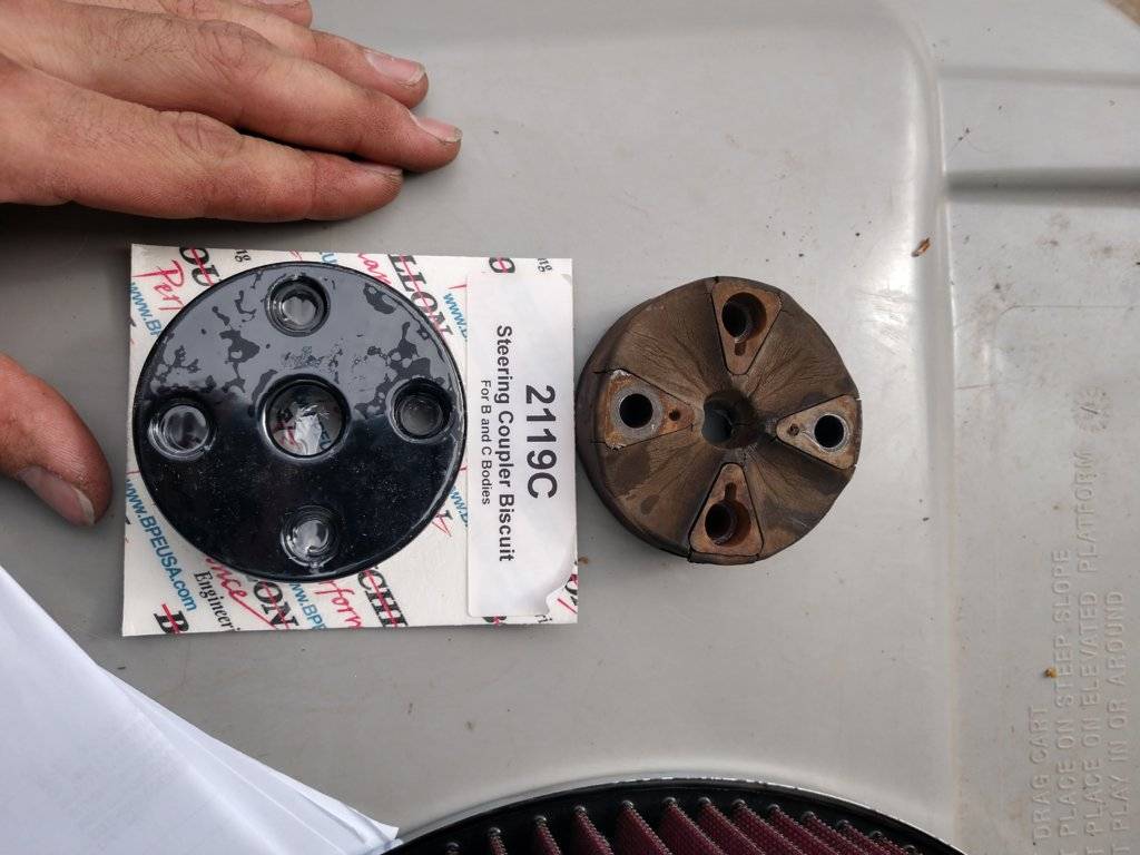

    Got the new coupler in. Also the new idler arm. Just a few things to button up now. Some new rubber next week and she's good to go! Another note. The amp guage seems to be reading negative all the time. Just slightly on the d side of it. Is that normal? Everything is brand new. Alternator. Ignition switch. Voltage regulator. Battery. It does not stay running when I hook up the battery. What could it be? Thanks!!

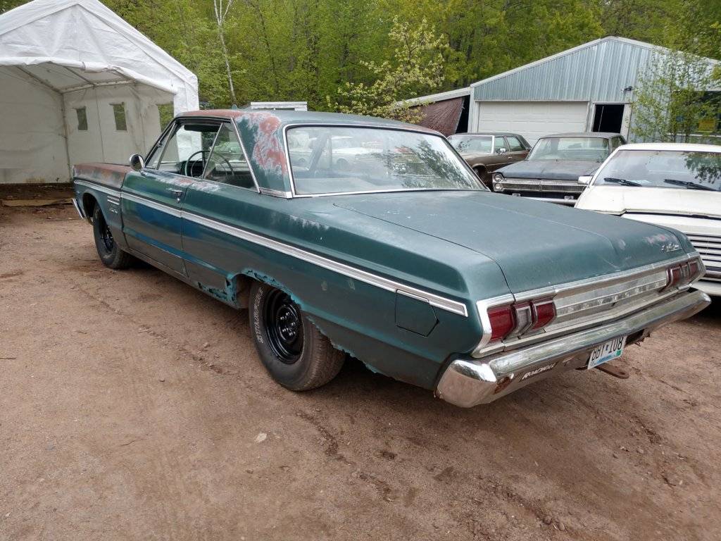

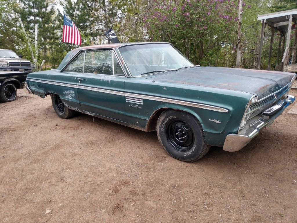

    Here an update on the blue sport fury. Most all odds and ends are buttoned up. New tires last week. Will be ready to go next weekend! Gonna drive it to work a few days this week as well! IMG_20190525_142208030_HDR.jpg IMG_20190525_142227430_HDR.jpg
