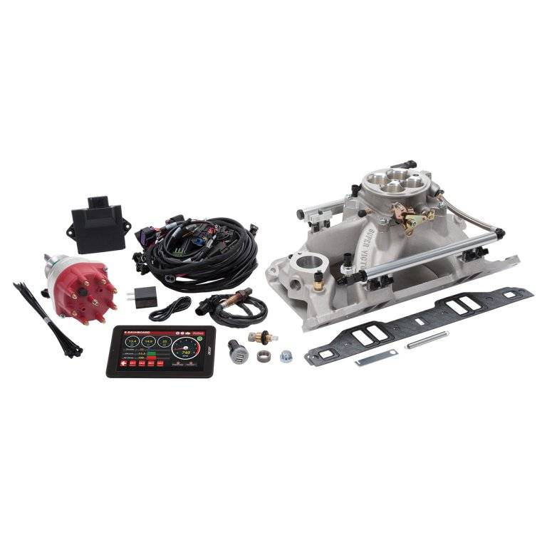

Going forward . . . it would seem that something like the Holley Sniper EFI family could provide a less-cumbersome system than any OEM EFI back then. Might be able to use the existing fuel supply system and adapt the Holley system to it? They now have 2bbl Snipers, which could be bolt-on situations rather than going to one of their 4bbl systems. This would keep the original "intent" of the car, too, just need a normal Chrysler 400 2bbl air cleaner, painted silver to complete the conversion.

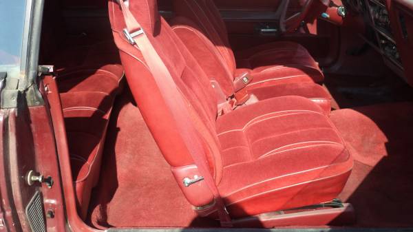

there were 2 issues for me that made it easy to let go - the driving position.
im 5'10" and at the time was around 230lbs.
the beautiful looking seats were comfortable but after a while i noticed that the seat bottom was too short - it ended closer to my butt than closer to the knee.
road tests of the day mentioned this.
i found this uncomfortable especially after driving 1 of my salons or even the 81 cordoba & mirada i had. the cordoba's seat was more comfortable and more supportive especially towards the knee. i even considered swapping in cordoba seats but that wouldnt have dealt with issue #2.
the imperial's seat just didnt extend far forward enough - heres a pic of the mirada seat.
and issue # 2 was that the steering wheel is offset to the right.
the combination of the too short seat and steering wheel not being centred in front of the driver really began to irritate me, especially after driving the salon or rivieras. ( ive prob had 7 boat tails).
i nearly bought a sinatra imp last year but as soon as i sat in it the seating /driving position irritation came back........

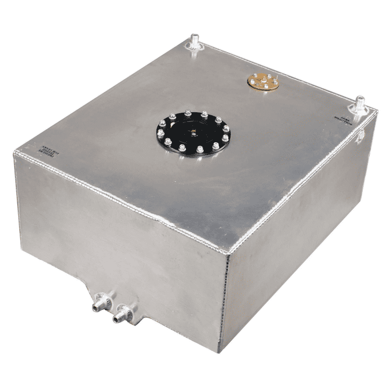

No one has mentioned this or answered the question...
or could I actually have a fuel cell hooked up and it won't be an issue?
A fuel cell is not a good idea and whoever mentioned that to you is somebody that you should not take advice from.
You'll have issues matching the gas gauge, it will take up a lot of trunk space and be a PITA to put gas in. Plus it's an Imperial! Not a race car.
Typical fuel cell.

Thanks very much Mark for the comprehensive review of your overall thoughts and the downsides of those cars as I am confident I would find the same irritations as you did if I had spent some time in the driver seat. Given the issues with converting the fuel injection as well, I can see why there are so many on the market. I think your comments will cause me to drop one of those off my "would to like to own someday" list. I also believe owning a Mirada or Cordoba instead would be a better overall choice if one can be found with low miles and garage kept all its existence.
Steve
I'm 5'9" and I thought the seats in my Mirada were very comfortable. Never had any issues with the seats or driving position or anything. One thing I've always worried about with the Imperial (assuming it's already converted to carb.) is that if the digital instruments went faulty, it'd be difficult and expensive to repair. But I only just now realized that you could probably just swap the whole instrument panel from a Mirada or Cordoba into an Imperial. I don't see any reason why you couldn't.
Now that I re-read that last post, am I seeing that the Mirada/Cordoba seats are different/better than the Imperial seats? I had no idea!
The Cordoba buckets fitted me like a pair of slippers.
I'm guessing they were all b body buckets under the fabric.
