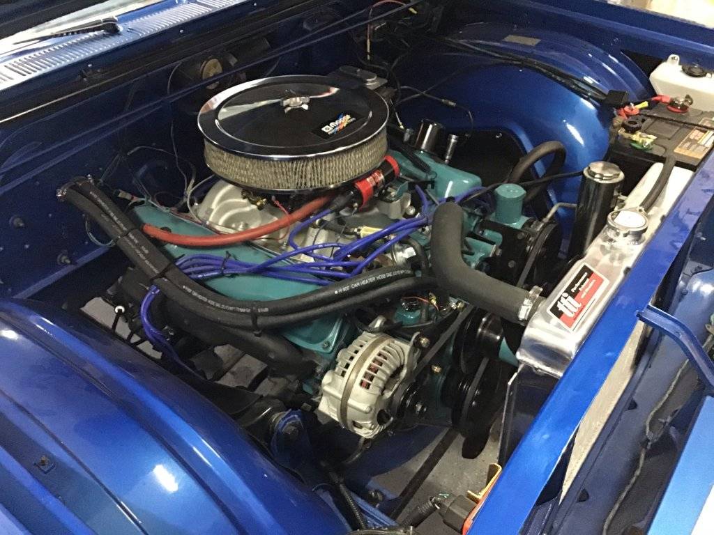

On my 65 fury I have an aftermarket air cleaner so I vented my valve cover to the back of manifold I just ran it for awhile to charge up the battery and noticed some oil on the hose if I pinch the hose you can really feel it sucking and the idle drops way down, does this sound normal ? Also would I be better off running the hose to the air cleaner ? Thanks for any help.

That hose is not supposed to be hooked up to vacuum.
As part of the early emissions packages, it vents into the air cleaner housing. The PCV on the other valve cover IS connected to manifold vacuum and draws (when the engine is running) through the PCV through the valve cover, through the crankcase, drawing air from the breather on the opposite valve cover.

Yes you are tied into the main engine vacuum port. The purpose of this breather is crank case ventilation. You are creating crank case suction and will be burning oil as it is pulling it directly to your intake manifold. When you put it on the air cleaner where it belongs, you are only putting a slight vacuum to the breather.
Where you have it hooked now is like putting the shop vac hose about a 1/4 inch above the surface of a bucket of water, you will suck up the water. When it is hooked to the air cleaner it is more like the shop vac hose is a couple of inches above the water, it will create a negative pressure, but not enough to lift the water. (there are probably better analogies, but should help give you the idea)

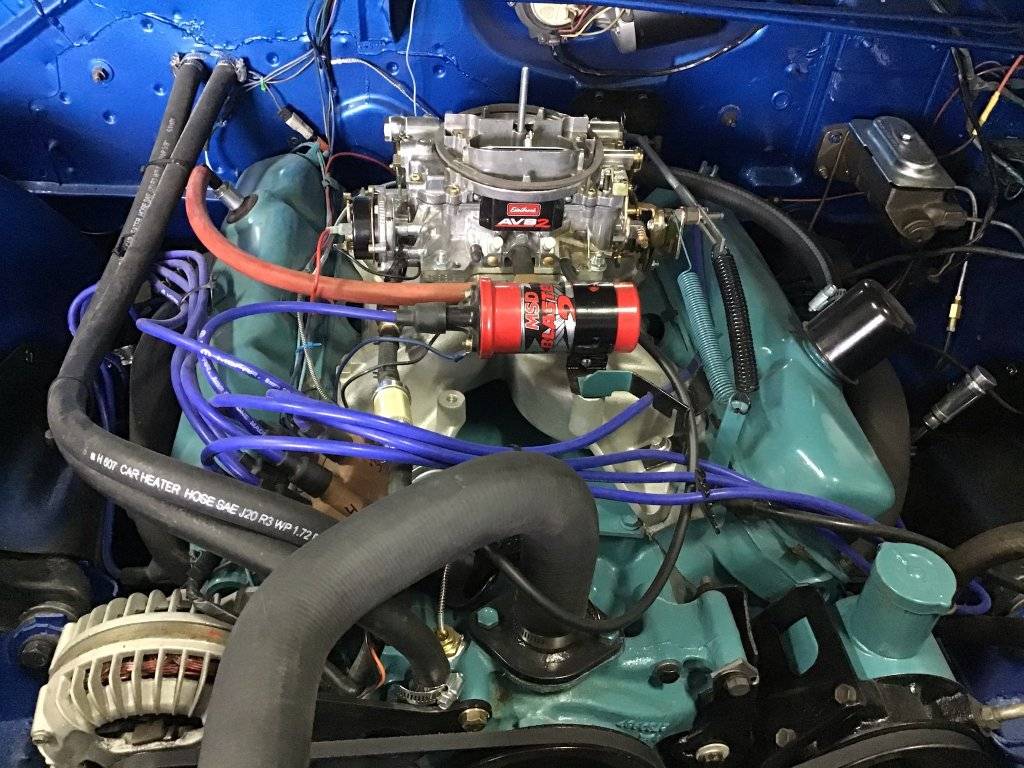

There's a red hose going from the manifold to the PCV on the right valve cover.
Thanks for the input guys , that’s right big John the red hose goes to my pvc valve does that part of it look ok ?
Yep, although most don't use a right angle fitting, but that will work just fine.

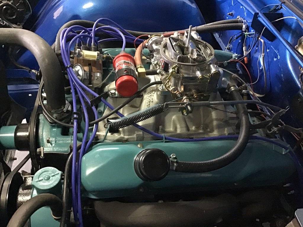

You can just pull the hose off the breather to run the car without the air cleaner on.
I think there is a place on my air cleaner I can mount a nipple for a hose. Or can I just run it without the breather hose ?

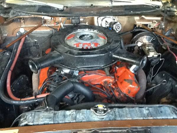

Normally, with 1969-1973 c-bodies I've worked on, the PCV is on the left (driver) side and there's an opening in the throttle linkage bracket so the hose can run to the fitting at the center rear of the carb.
Then the breather is on the right (passenger) side such that the throttle and kick down linkage don't interfere with the hose to the air cleaner. Note: parts stores sell open breathers that do not have a hose to the air cleaner

1969 Breather on left side, PCV on right.

Is it me or is that hose to the breather coming off the back manifold vacuum fitting?

Just disconnect the hose from breather and plug where it went into manifold. It will chug a bit of oil smoke out when under load (no vacuum for PCV to work) all that is normal. With factory air cleaner it is routed into the housing somewhere (varies by years). It will not hurt to leave it vented to open air, but it may introduce smoke vapors to HVAC system or make a oily spot that will need wiped every now and again.
Most aftermarket air cleaner bases have a spot to incorporate this. It will be flat, about an inch wide, by two and a half inches long. There may even be a half inch hole, with two smaller screw holes on either side stamped into the metal. Any hot rod shop, and possibly most parts stores will have the plastic nipple you need. That's the way I would go.
