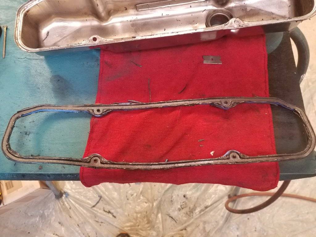

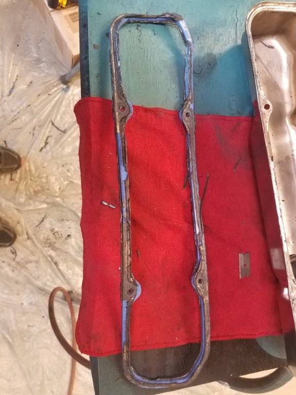

    I just got a set of 4 bolt valve chrome valve covers for my max wedge project and spent about 2 hrs peeling the old silicone gaskets off of them. The previous guy had gotten carried away with the black RTV sealant. From the looks of the covers they were leaking anyway.
