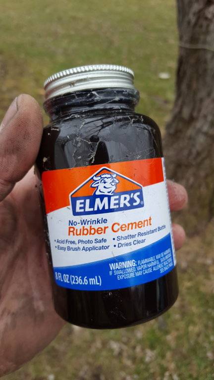

Thanks again for your advice CBODY67. Just a little update. Was pondering using some sort of glue or RTV to make an airtight seal. But like I mentioned earlier, I use the vents a lot in the summer, so a permanent caulk-like sealant wasn't an option.
But I did come up with something.
It may be a bit messy to apply, but once it dries, it cleans up easily. Should be no problem removing it all in the Spring.
If you're careful you can remove it by rubbing it with your fingers. How well it looks afterwards obviously depends on how much time you want to spend on it, but it sealed the air leaks.
