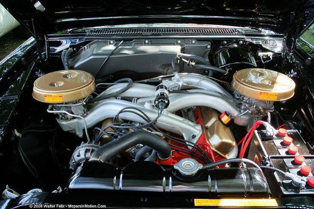

413 can be as cool as a 440 your car would be really awesome if you got a set of cross ram intakes be the only 67 Fury with them.

Damond, If you do decide to do the ramz you're looking at two simple modz to make it workable KINDA. First iz to extend the length of the trans dip stick AND tube by about ah foot so you can reach it to check it once in ah while. And second is to take a serious hammer and persuade a section of the passenger side inner fender to relocate ah bit closer to wheel opening so that side ram will lay down and you can bolt and torque it to the drivers side head. And then theirz the thing about ditching the Magnum or TNT up sweep headers for plan ole' logz too 'cuz they won't fit under the rams. Theirz ah bit more too but hey, What Eye Candy!

Thanks Jer! That would be a beautiful set up! I read the thread the other day about the trans tube length, didn't know about the need for persuasion. I think before I'd go for the long Rams I'd like to have the ole 413 punched out to 426. I'd love to have a few more cubes. Nothin at all against the 440, it's just that it's one of the most common of the bigblocks.
I'm not sure that cross ram setup would even fit! The engine compartments (56-62) were taller,and wider. But it would definitely be cool! Now a hood with two big air cleaners would do it.:laughing4:
